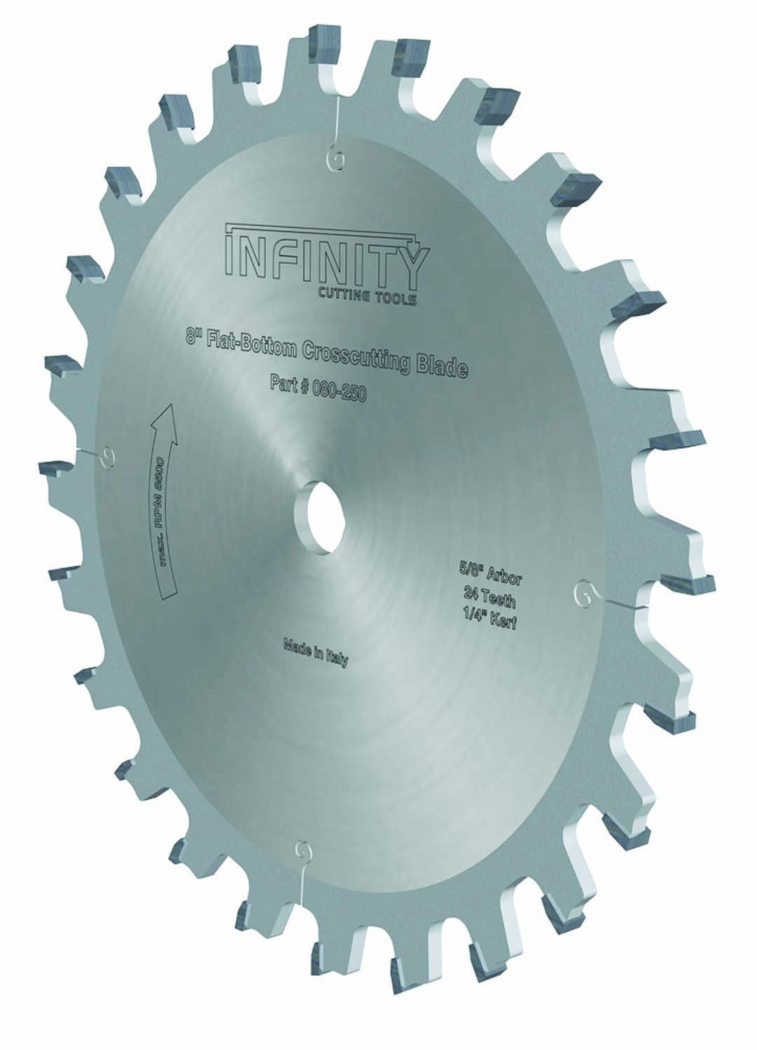

I really don't know of a wide kerf saw blade that will work well in anything less than a worm drive saw. The torque requirement is just too great. (same for Dado blades..,.) Plus the safety factor.
Kerf Width
Saw blade kerf is generally measured in thousandths of an inch. A typical “full kerf” blade will have a kerf of about 1.110”. Some heavy duty blades can have a kerf of 0.125” (1/8”) or even 0.172” (11/64”). If kerf is too thick for a weak circular saw (saws ranging less than 2 HP), it will rotate below the average speed and start to grind the wood. Thin kerf blades will generally be 25% thinner, creating a cut of 0.091” or about 3/32”. The thinnest kerf circular saw blades currently made are 0.059” (about 1/16”) thick. This is especially helpful for making precise cuts on engineered lumber or plywood. These thinner blades cannot absorb impacts so well, and are more prone to bending from stress than thicker blades. Therefore it is extremely important to ensure that the wood doesn’t twist in the saw, jamming the blade and possibly bending it. The blade plate on thin-kerf shouldn’t be bendable at any cost; in order to run straight, factory-engraved expansion slots are used to prevent overheating and possible deformations. Although they can be resharpened, they tend to get dull quicker and not be resharpenable as many times.
this is quoted from http://circularsawblade.net/kerf
I measured the thickness of the dado blades I have. Never put them on the circular saw, its too hot and I didn't see the point. Each dado blade is 3/32" thick and 3/16" on the cutter. They are meant to be used with at least two blades as the cutters are offset to create a smooth cut. The blade I have on the circular saw currently has about 3/32" on the cutter and the blade is less than that. It says on the Dado package I have (for table saw and radial arm saw only). I got the 6" set back when I had a portable job site table saw and 6" dado was all that it was rated for. Cutting 3/4" dadoes about 3/8" deep in one pass with it was all the saw would really handle in plywood. Cutting a strip between two boards would be even harder.
