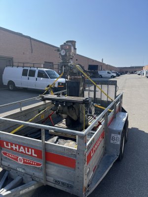

Heading out there tomorrow morning with a trailer and my machine moving stuff.

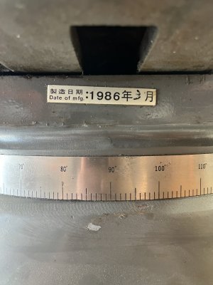

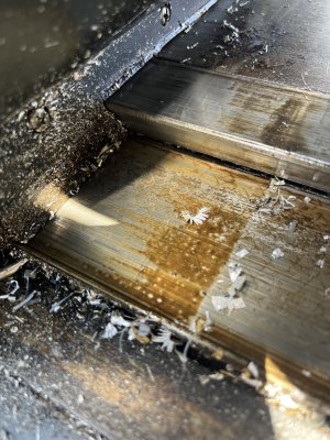

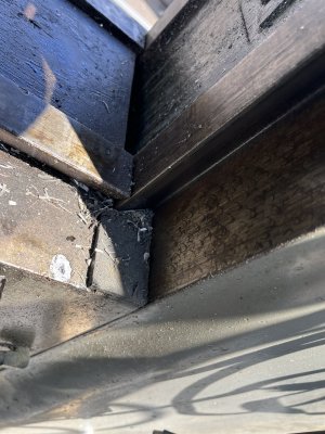

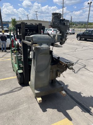

The free machine is real!

A variable speed head too, I paid $ for my LC1-1/2 and didn’t get that! What are the odds that the head noise is worn out sheave bushings.

EDIT: Those little dually trailers are great for moving that size of mill.
