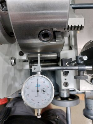

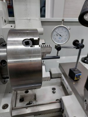

Hey all, my 707 is running great since I setup about 4 months ago. The 4 jaw chuck had a bad vibration in it when I set it up. So I sent it back and under warranty busy bee sent another that was said to be tested before sending. This one shakes the machine as bad. Up to 500 rpm it's not really noticeable but after that it's bad. Concerned about bearing damage and chatter in parts if I used it. Has anyone else had this trouble with the supplied San ou 4 jaw? 3 jaw ans naked spindle are vibration free at all speeds. Is there a way to fix this without a dynamic balance?

Do you have a part in the chuck? Is the part centered? If not, are the jaws all evenly in? Did you put dial indicator on chuck body? What is the runout?

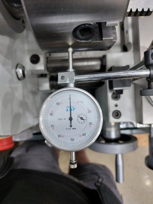

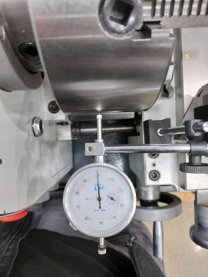

Just a pin centered in the chuck
The Runout on the od is about 0.001".
The face has about.0.0002" runout.
I agree that 500 rpm is not fast but anything above that and it shakes the lamp, tools on the top of the lathe, the entire head stock etc... it's all bolted to the concrete too.
