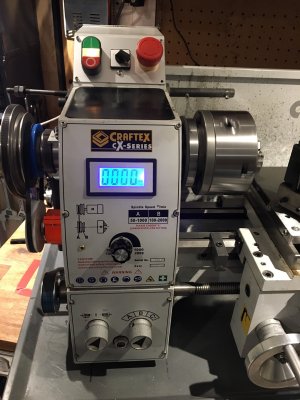

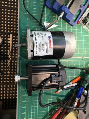

Well thanks to DavidR8's surplus motor, my little 10x22 is sporting some new found power, a few images.
The first image is the interesting one, the 2HP BLDC motor is smaller than the original 1HP brushed, technology moves along.
More or less a bolt in, same flange dimensions, Needed a pulley for the larger shaft 14mm vs. 12mm. Made a new control panel to squeeze in the E-Stop.
So now I have a surplus 1HP motor and matching KB Electronics control board..

This is actually a BLDC motor with the original Weiss driver board.
I have this setup for two modes: manual and CNC, I need to make a point of turning the pot down when in manual mode.
I'm actually more concerned with de-acceleration back EMF, especially if I hit the stop or E-Stop at high speed. This is one of those I guess I will see what happens, hopefully the driver board has some form of over-voltage protection. The board design is similar to say a KBIC motor controller (focus on minimal components / low cost) in that they are not isolated from the MAINS. Makes for a bit of a PITA when interfacing to CNC controllers that are typically running close to earth potential, because of the large common mode voltage on the motor controller board. I actually found the factory MAINS wiring on this board rolled, so as factory wired there was 120Vac WRT earth on the common of the control inputs. I rolled the H&N to match the factory wiring diagram so the 120Vac is closer to N, however the common mode DC is still nasty. Fortunately I'm using a MESA card and their analog output is fully optically isolated because MESA knows and does things properly :) For the F/R. On/Off etc. I'm using small relays to interface to deal with the MAINS voltage and high common mode voltage issue.

This motor works with the matching board, this style motor has a built in encoder so the driver (motor control board) is aware of the exact position of the rotor so it can create the rotating field in the stator. So you can't just swap the motor.

I ordered the pulley. Same thing I wanted to leave all the original stuff as is, so I put the original motor and pulley in storage along with a bunch of other stuff that got upgraded out. ELS is a really nice upgrade.
