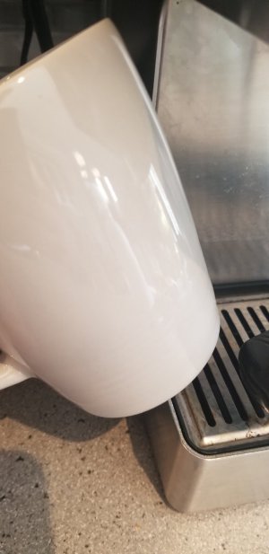

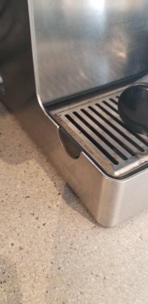

I'm in for a little project my wife asked me to do, modify our stainless Seaco expresso machine so her cup easily gets under the hahdle.
I know cutting stainless can be a hard task, if it still need to "look good".
Would appreciate any tips on this

More pictures please! How high is the cup and how low is the opening??????
Hard to make any kind of suggestion without additional information and better pictures.
From what you mention I would attempt to lower the grated shelf somehow? A tight fit will cause many an accident with steaming hot coffee and you don't want that. Get a bigger coffee maker, accidently drop the cup, Devil made me say that.
I'm guessing that you need to lower the lip that holds the grate in? If it is not a rolled or hemmed edge, you should be able to to a nice job with a cutting disc in an angle grinder and finished of nicely with a flap sanding wheel in same grinder.

I would look to see if the supports under the SS plate could be lowered or cut down.
If you want another SS grill, get one water-jet cut and bent to suit your ExpressO machine to result in a lower CUP seat.
