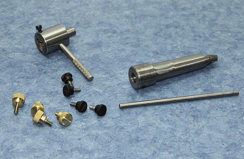

I found a 3MT stub in with some scrap metal at work one day. I had it for quite a while before
I came up with a use for it. I wants to replace the setscrews that hold the dials on my mill as I

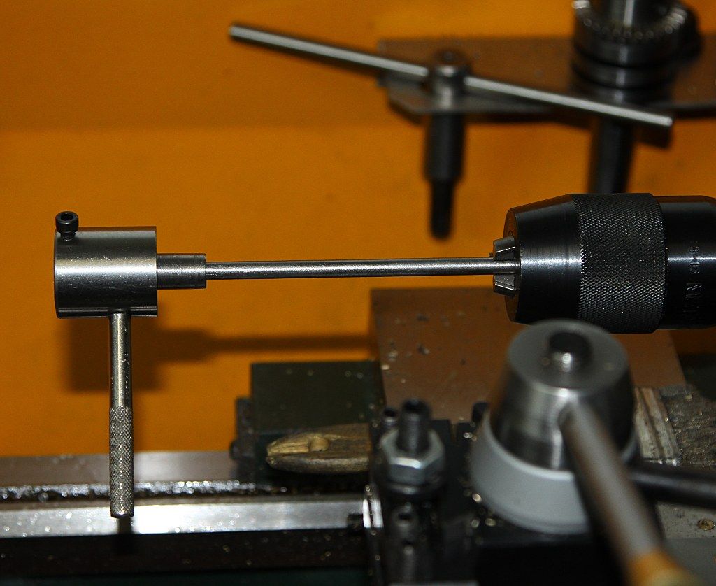

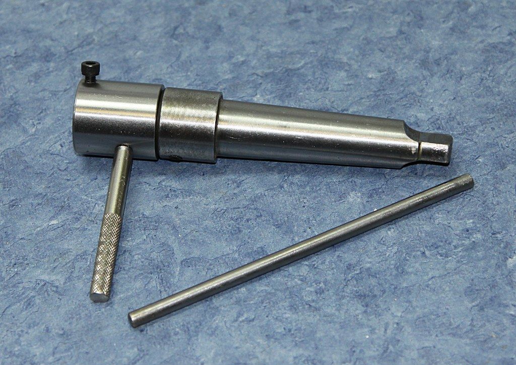

disliked the ones that came with it. I made a tool to hold a die nut in the tail stock or tail stock
chuck. It does the job starting the die straight and being able to release the handle when the
thread is complete.
Yes nice job, those are handy.
I have a commercialy made one for round dies and a homemade one for hexagonal dies.
