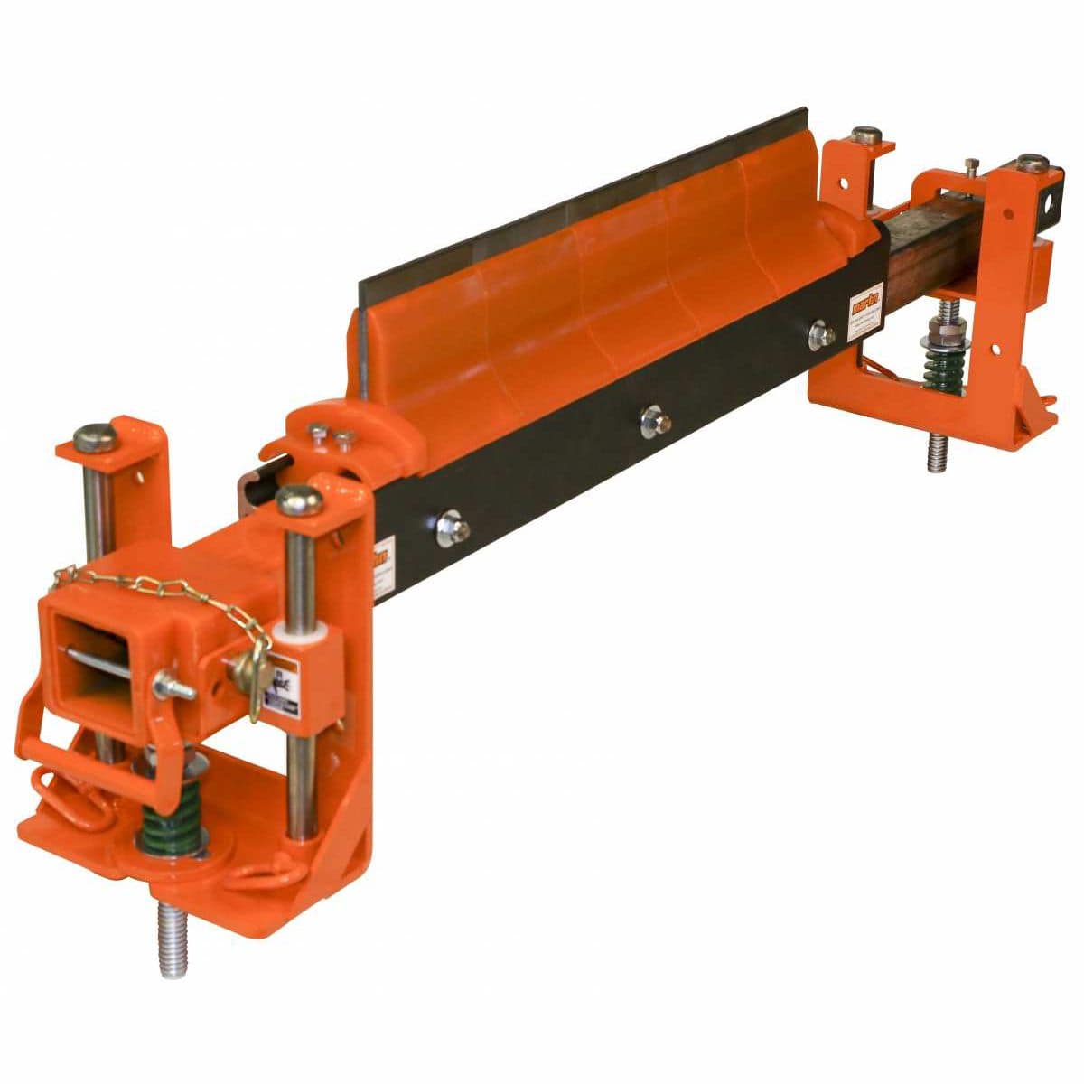

It's off one of these style belt scrappers
Plasma torch? Would that just wreck the carbide though?
Hmm we cut chrome carbide overlaid pipe at work all the time so probably work ok I think. Probably can test that out in 2 weeks ish when I'm done at work.
I was think maybe if lathe tools don't work out I could maybe use for scraper for new to me lathe experiment
Yes, even edm affects the immediate area, though some tooling companies used it to make formed blanks. Ground blanks had more consistent wear and better finishing and tool life.
I doubt that this compound would hold a sharp edge in anything other than cast iron, it’s alloying is not intended for impact or chip resistance at a cutting edge, it’s more for wear resistance at a blunt edge.
