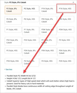

So, I need a 1/2" P-Type (actually T shaped) cut off blade..
Which one should I get???? Too many choice here and they all appear to be the same price? This is like going to Subway:mad:
In that screen shot, I've already selected this...
From your screen grab it appears to correspond to KBC paper catalog. They show 2 sizes for 1/2" height, the difference is width. I think I'm using M2 vs the 5% cobalt which is a bit better but price jump.

P1 W=1/16 H=1/2
P2 W=3/32, H=1/2
N, not quite sure I follow. Where do you see that?
You mean the x 4-1/2 (Length = 4.5")?
I don't have a link to your amazon ad but what happens if you click on the button, does it refresh the information?
Otherwise sorry, I don't know.

Ya, I'm wondering now if it's a filtering problem on Amazon. Once I select size, I shouldn't be presented with so many options?
So the P1 vs P2 vs PX is the width specification? What's the N at the end mean
N means narrow.
Size P1 blades are 1/16" wide and are the most commonly-used size. P1N blades are 0.040" wide. These thinner blades are good for small work. P1X blades are 5/64" wide.
Ok, I figured out the Amazon confusion now.
If you select 1/16 it auto selects P1, selecting 3/32 auto selects P2 etc etc.
Doohhh.:rolleyes:
