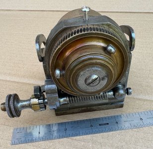

For no good reason, I picked up a weird little gizmo on the weekend...a mini, user-made indexer.
Next to the worm gear 'teeth', you can make out that it is marked regularly around the circumference. There are 48 divisions so it easy enough to divide into 2, 3, 4, 6, 8, 12, 24 or (of course) 48 parts. There is a sping-loaded wedge that clicks into the small notched wheels next to the knurled knob. These give decent registration (and more!).

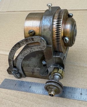

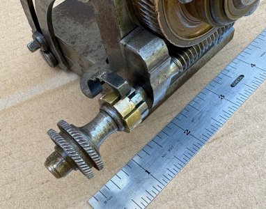

The spring-loaded wedge can be adjusted to engage either the larger brass notched wheel (8 notches) or the smaller steel version (12 notches).
I believe the worm ratio is 90:1. It isn't easy to count as there is not a mark on the knob to easily see full turns. I did note, however, that it takes 15 clicks on the 8 notch wheel to advance one marked division or 1/48 th turn. (15/8 X 48 = 90) Thus it takes 720 clicks on the 8-notch wheel for a full rotation or 1 click equals 1/2 a degree! Using the 12-notch wheel means 1 click is 1/3 of a degree.
With the worm ratio, the notched wheels effectively act like different rows of holes in a more-typical dividing head plate. One could even make custom notched wheels to achieve additional dividing combinations.

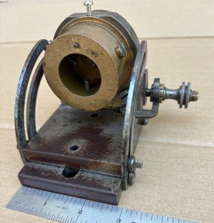

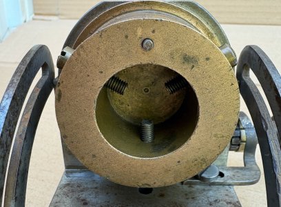

The problem, though, is the work-holding side:
The hole is about 1.170 diameter by 0.849 inches deep. Not exactly standard for anything I'm familiar with. No through hole, either. I think it might be possible to adapt it to use, say, ER16 or ER20 collets. Not sure I want to go to that trouble.

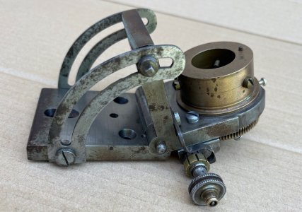

Finally, it can be set up an angle from horizontal:
It can't go quite to 90 degrees due to built in stops in the hinge.
Overall, I'm puzzled about this thing. It is clearly user-made and took some very careful and skillful work to build. But the work-holding side seems beyond crude by comparison.
Would this have been an assignment for an apprentice? I thought that such projects were usually to make something that the builder could continue to use throughout their career? Or is it maybe for some specialized trade?
Thoughts?
Craig T.
I love stuff like this and wish tools could tell stories. My best guess, it that it was made by a skilled craftsman to serve a purpose and solve a work holding/indexing problem they were having. We're spoiled these days as we can order a decently made dividing head at night and have it in a few days for little dollars from china. The old boys didn't have that luxury, and things like this were born out of specific needs. Whatever that need was, they did a good job on it. A very good job.
The work holding end might be to hold a chuck on a shank or something. Perhaps for swapping between lathe/mill or something. We may never know what it was actually made FOR, but I can think of lots of uses for it now.
