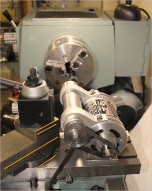

cross slide indicator assembly v2

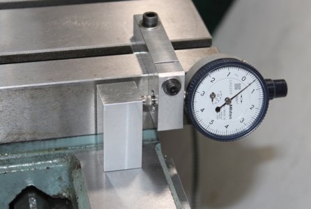

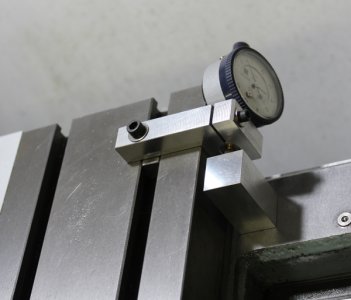

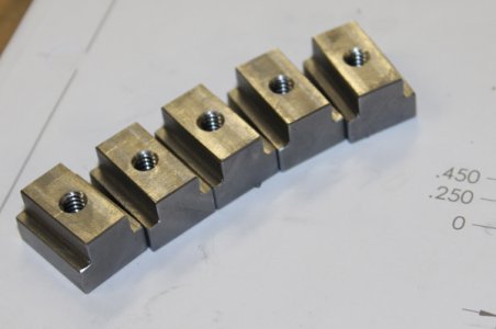

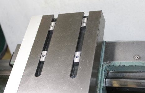

I made some tee nuts for my cross slide for another project. This gave me the idea to make a better, more universal holder for my 0.0001"dial indicator so I can see finer increments than the DRO resolution. I could have extended the holder section a bit more but I tried to keep it compact & rigid, close to the table edge as possible. I can angle the dial at 45-deg which is good enough to see. I can flip the indicator in either direction or add plunger extensions so I think I can reach most any situation. My other clamp was kind of limited & more finicky.

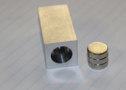

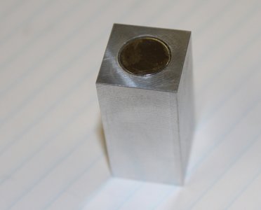

I made a magnetic stop post from aluminum using three 12mm x 4mm neodymium magnets epoxied in a milled hole. It sticks OK but I wish it had more power. Cast iron isn't super magnetic to begin with. I can kind of fit a mag base on there but its a bit clunky. I can make a bar that ties into a plate on the rear of the machine, but the plate is used to hold my DRO encoder so I don't feel like taking it apart unless I'm sure.

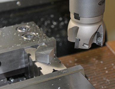

Shop tip I saw on Tom Lipton site. When you have stubby lengths of stock that need to be milled to the exact same length, you can use 2 Vee blocks to trap the corners. That keeps them perfectly in 2 dimensions simultaneously. A parallel resides under the part in between the parallels so once you have the Z dialed in, just whack them down to the same height. I like this better than standing upright in the mill vise with a square. Or extending off the end of the vise jaws because you ideally need support on the other end & some other kind of stop mid way on the vise jaw. Hope this makes sense. The tee nuts & mag block was done this way. I wish I had longer but thinner blocks for this purpose. My little ones will drop through the center slot so I have to keep them on one side resting on the vise bed.

Very nice drawing / part, @PeterT.
You planning to use the TP grinder for super precision work down to tenths?
I wonder if you might have to use the TP itself as the reference surface - it would take care of both cross slide and compound slide deflection / errors.
Hi Rudy. Yes, its part of an ongoing (mostly fiddling around) effort to improve the TPG finish & consistency. The current results aren't horrible but I'd like them better. For straight-in grinding, I'm considering mounting the TPG directly on the cross slide over the tee slot area. I figure that might make a more stable foundation & maybe reduce some potential sources of vibration play compared to mounting on the compound slide. When angled grinding is required, no getting around the compound mount of course. But that also means extra mating surfaces are involved: TPG to small footprint adapter plate, adapter plate to compound block via tee nut, compound dovetail sliding surface, compound assembly mounted to cross slide. These surfaces should be considered locked down, but in reality who knows. A little play here & there and all stacked vertically wedding cake mode, maybe adds up?
Re the dial indicator, my DRO reads 0.0005 (diameter) resolution. The dial reads 0.0001 increment, so advancing one visible tick mark = 0.0002 diameter reduction. I'm not expecting that kind of true accuracy because of bigger variables (wheel wear, heat, vibration, spring passes ...) but maybe its a better feedback device of what is truly going on. My other system worked ok but was clumsy. One thing I picked up with my liners is when the TPG is running, the cross slide will float very easily as soon as the dovetail lock is releases due to micro vibrations running through the machine. You can see the indicator needle oscillating back & forth either side of the set position. I think just normal leadscrew backlash allowance will allow that & lets face it, a 90's Taiwan lathe is not a surface grinder. But what I found worked better on final finish passes was turn the motor off, reset Y increment (with dial reading), lock cross slide again, then power on again.
The other mode I considered was canting the compound at a shallow angle & incrementing that in using the angle math for equivalent diameter DOC. But I don't have DRO on that axis & not a good way to mount a dial so 100% dependent on the manual dial reading.
I'm making a few arbors too which are more stout & hopefully less deflection than what I used last time. Its been a bit challenging because Themac has a funky proprietary taper angle in their spindle & I don't have a taper attachment on my lathe. I'll post some more pics as I get closer but anyways, that's kind of what this is about.

Here is roughly what I'm thinking for TPG re-orientation. We'll see if it works. All I am really risking is a bit of plate material as long as I don't shoot my eye out. The orange lines correspond to long winded potential sources of surface contact play. One disadvantage is OD grinding - sparks go up vs. down which is not a good thing. I think I could re-wire internally or better yet a fwd/rev switch. But my principle goal is ID grinding so spin direction doesn't really matter. I don't have a lot of run time / experience on the unit & every combination of material seems to present another permutation of stone & speed & feed. TPGs are bulky so often difficult to get into position & generally don't play well with tail stock support.

Moving the TPG to the slotted part of the cross slide should give you a massive improvement to the rigidity.
