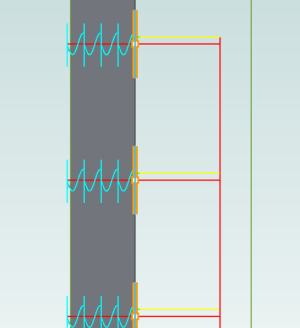

Creating this and the CAM that went with it was amazingly easy and fast with AlibreCAD/CAM. A friend tried it in Fusion360 and apparently a milled pocket has to have a bottom or it's not a pocket. In AlibreCAM (MecSoftCAM) a pocket has diameter and depth and based on the endmill and rpm the path is circular with a specific depth until the depth is reached. If the depth is larger than the model thickness Fusion360 complains and won't make the pocket.
I whipped up a quick model in Alibre. Easy Peasy. Is it actually easy in Fusion360 and he's just gone down the wrong path?
Side view of the mill path showing a pocket milled deeper than the material.
That would be easy in Fusion as well. I think maybe he misunderstood the assignment?

Apparently not easy in Fusion.
So here's the basic design.
1. One sketch to create the rectangle 24x36" (or so in metric) extruded up to 19mm (3/4").
2. A second sketch to create an array of 20mm holes that are 40mm apart extrude cut to make holes all the way through.
This took all of a few minutes to create.
On the CAM side if one used a milling cutter that was 13mm diameter (or 1/2") it's easy to just use a hole profile process which spirals down cutting away the inside of the hole. But apparently the tool in use is 1/4" (about 6mm) so a hole profile leaves crap in the middle that can fly out or jam.
The better way with that small a cutter is to use the pocket process which cuts a pocket. This time 3mm deep each time with a tool overlap of 25%. the 19mm divided by 3 mm means each hole take 6.333 passes to depth. Or if we want to make sure we go all the way through we make the pocket depth 21mm for 7 passes.
Apparently Fusion balks and refuses to create a pocket deeper than the material. I'm not sure why if the drawing shows holes.

The fusion "Bore" command does let you keep boring through the bottom and beyond, but it does leave an island of stock in the center. For a quick answer in the past I just drilled a large pilot hole first and then ran the bore cycle to get to final diameter. I was trying the pocket command which does let you nicely ramp down and simultaneously step over to the bore diameter. But your friend seems correct that you can't get the pocket command to blow past the bottom of the stock, it just stops at the hole bottom. The pocket is also quite slow - with just the default settings these 9 holes had a 33 minute cycle time. I'm sure you could drill and Bore command faster.
I had no problem setting up pocketing in holes with the 3d pocket command, perhaps the 2d pocket command is more limited.

The AlibreCAM (MecSoft VisualCAM) differentiates between pocketing any old shape and pocketing a hole. Same with profiling which can be inside a curve or outside a curve. The 3D operations just have radial and spiral machining operations.
Using standard pocketing I can also do the hole but it comes out as a series of straight lines and with depth set to 1" on the 3/4" thick material.
Now if instead I ask it to use the CAD drawing for depth it doesn't extend below the work.
The G-Code is much simpler as it's just straight lines and fairly crude ones. After which once could do a full depth profile operation to smooth the edges.
What's sad is the generated G-Code still just uses lines but much shorter as it goes around the hole.
