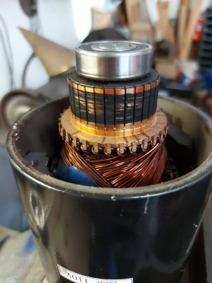

For a while now when I pushed the start button it would buzz then the motor would start. Lately a couple of times it would hesitate then start. The other day I pushed the start button and there was no sound at all but the RPM display lite up like it usually does and the motor did not start. Of course you are in the middle of something you want to get finished when something like this happens. I did some investigating, fuses wire connections etc. All checked out OK. Keeping the buzzing in mind I went to the push button switch and removed it. Looks like I can pop this thing apart, but will it go back together. I checked on line and Busy Bee had one in stock that they could ship right away so I ordered it then proceeded to take the old one apart. Not too bad. All looked pretty good so I cleaned the contacts and managed to pop it back together. Put it back in place still nothing. I am still thinking that maybe there is something wrong with the switch that I can't see like the magnetic coil not pulling the armature in. Just for kicks while I am waiting for the new switch I thought I would try connecting the motor directly to a 12 volt auto battery. The motor runs on 90 volts DC. Pulled the leads out and connected to the battery. Nothing, just like an open circuit. OK a good time to pull the motor out and at least give it a good clean because It has never been out. The picture shows what I found. So much carbon build up on the commutator that there was no connection. Cleaned it all up with some scotch bright and put it back together. Even with the 12 volts it rolled over quite smoothly but very slow do the low voltage. A word of caution here if you are going to take one of these DC motors apart. Hang on to the armature very will because the magnets are super strong and you could do serious damage to a finger or two if the the armature snaps around in the housing. All back together again and works very well with no buzzing in the switch. I guess I will have a nice new switch to put on the shelf in a few days.

Any idea why so much carbon built up on the commutator?
Not really. One Brush had the similar carbon build up on the face as the commutator. Everything cleaned up looking like new and the brushes didn't look they had very much wear on them. Maybe there was some kind of contamination left in there when the motor was originally assembled and over time caused the build up combining with the carbon dust.
I had similar issues on my CX700. The brushes looked hardly worn but new ones made it run again.

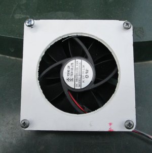

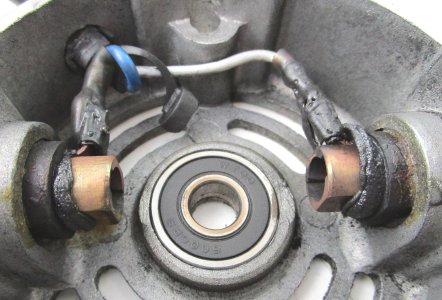

One of the major problems with these motors, having a permanent magnet field, is heat build up !
The heat from the armature can only escape via the bearings at each end. The built in fan is mostly ineffective simply because the motor is rarely running fast enough to get a reasonable air flow. I use an added 5 inch 12 volt ducted fan on my mill set to suck air up through the motor and out.

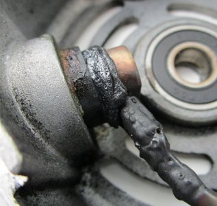

The other problem that is common, is the connections to the carbon brushes overheat and become bad increasing the heating. The net result is excessive carbon build up and higher than normal wear.
Cleaning the commutator as you have done will help.
I replaced the motor on my mill with a 180 volt, 4HP treadmill motor, a much better quality motor. I still use a fan but this motor doesn't even get warm.

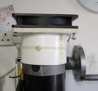

Whilst the same kind of motor is used on both the lathe and the mill, you will have to decide for yourselves how to implement a cooling fan on the lathe ! Since the lathe motor is horizontal and my mill motor is vertical the method that I used may not be suitable.
I used a piece of 100 mm (4") plastic pipe slit down one side and wrapped around the motor and held with Ty wraps whilst the adhesive set. I then cut a slot on either side for the brush holders, allowing the plastic pipe to sit further down and add stability.
Note that the air flow direction should be to suck the air out over the brushes and commutator. I also have a thermometer so that I can keep an eye on motor temperature.

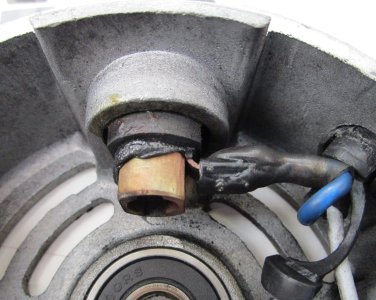

Hi Guys,
Here are some pictures of the original mill motor ! The supplier replaced the motor (twice) because of the heating damage.
In this picture you can see the damage that the poor connections on the push on connections created. The brush holder on the right has melted and allowed the holder to tilt.
The left hand brush holder isn't that far behind.

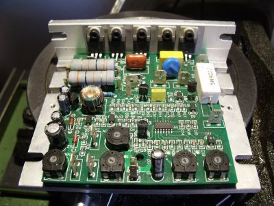

On the third motor, I took it apart and soldered the push on connector to the brush holder spade.
This motor lasted the longest until the armature shorted and destroyed the speed controller module.
I got a replacement from the USA for about $125. A KBxxx
I didn't have to do anything other than add the 0.2 ohm 5 Watt resistor. The large white ceramic one on the right of the picture. The unit simply fastened in exactly the same as the original one.
I wonder if the "KB" control boards in all these Asian lathes are actual KB boards or if they have simply cloned them?
