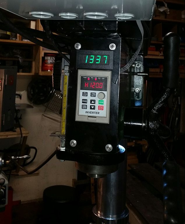

I don't know anyone who likes changing belts positions to change speed on a drill press. I cursed many times after drilling a 1/8" pilot hole then having to change belts positions for a 1/2" drill bit to finish the hole. I've had this project in mind for a while now and finally found great deal on a 1.5 HP three phase motor (thanks Chad).I bought an inexpensive 1.5KW (2 HP) vfd on Amazon as well as an electrical box to house it.

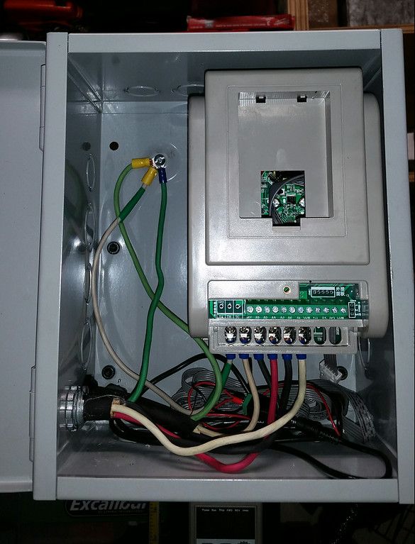

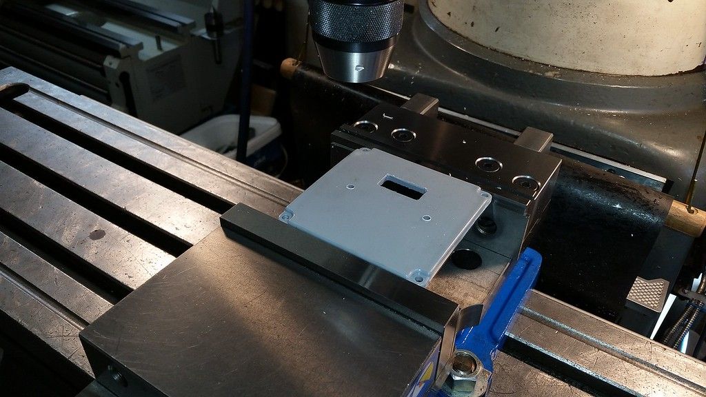

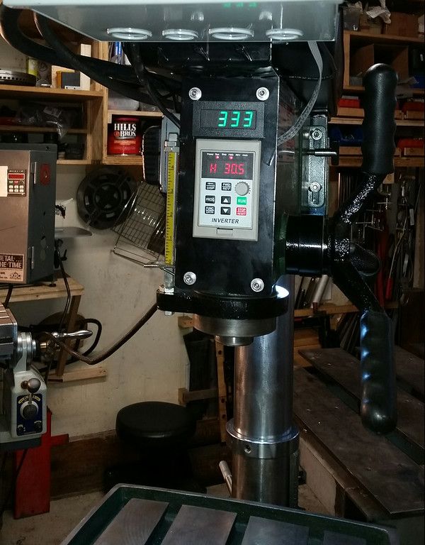

I made up a bracket from some 3/16" aluminum to hold the vfd, control panel and tachometer. I cut the rectangular holes for the panel and tach on the mill before I riveted the bracket parts together.

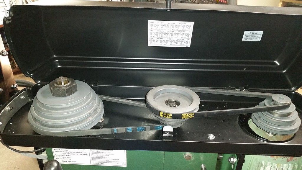

I removed the top belt housing along with the spindle, idler and motor pulleys. I used an automotive a/c compressor clutch puller to remove the motor and spindle pulleys. I had to machine a couple of pusher slugs to work with the puller.

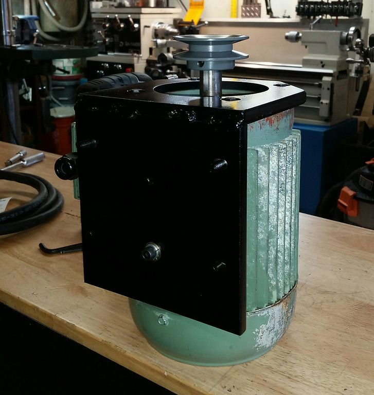

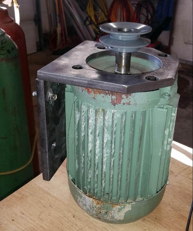

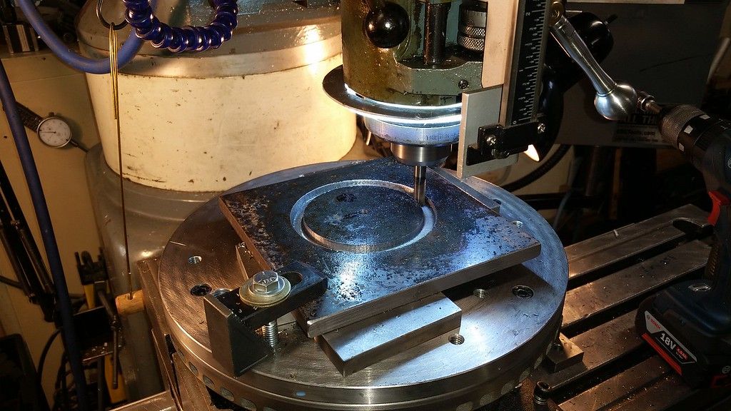

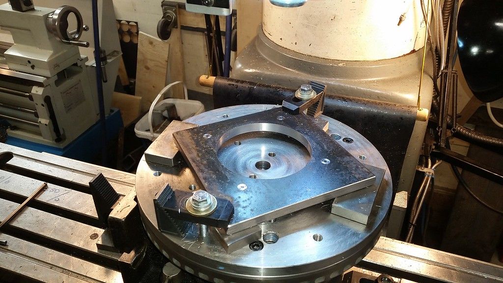

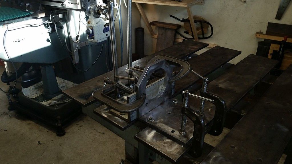

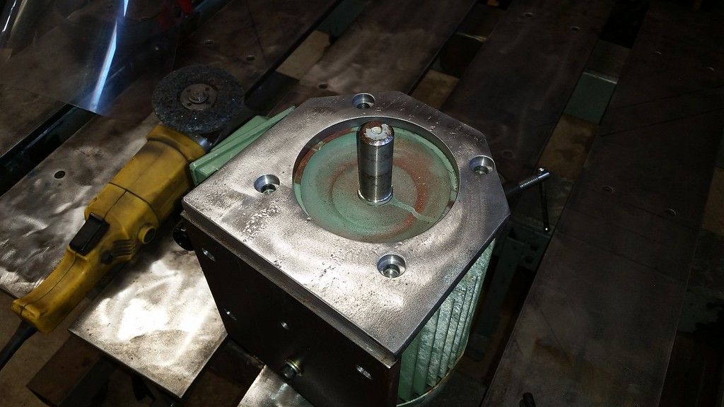

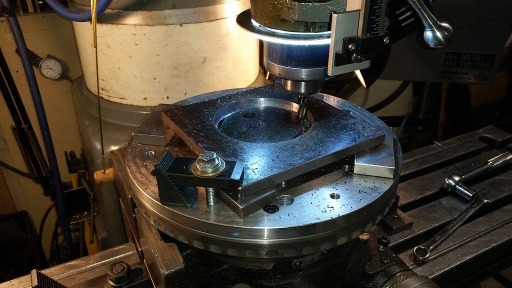

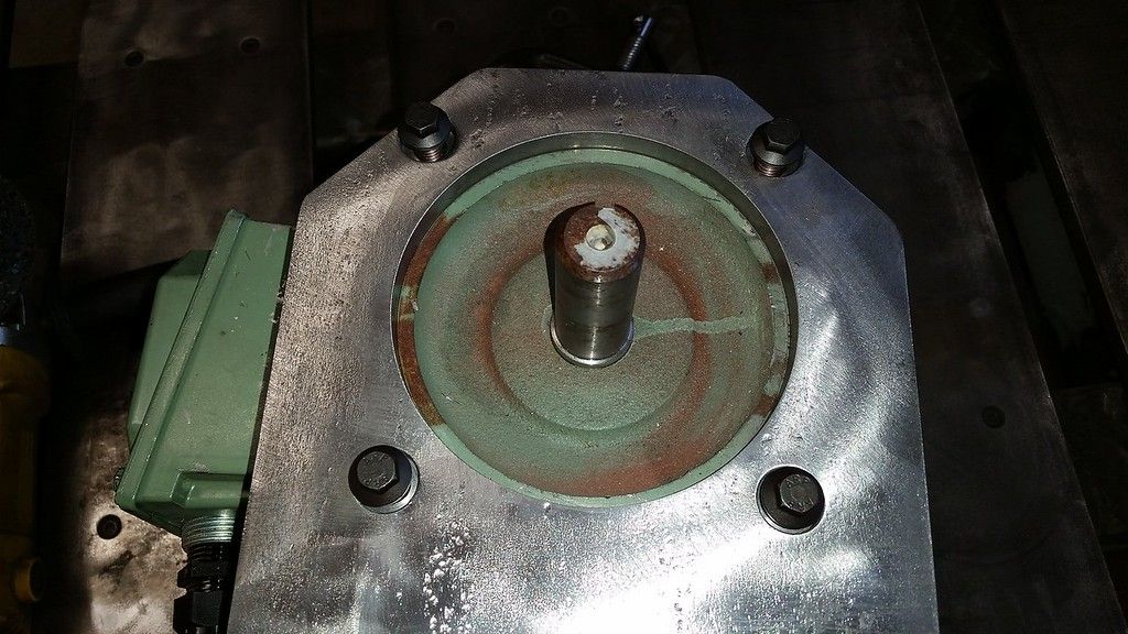

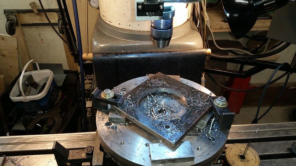

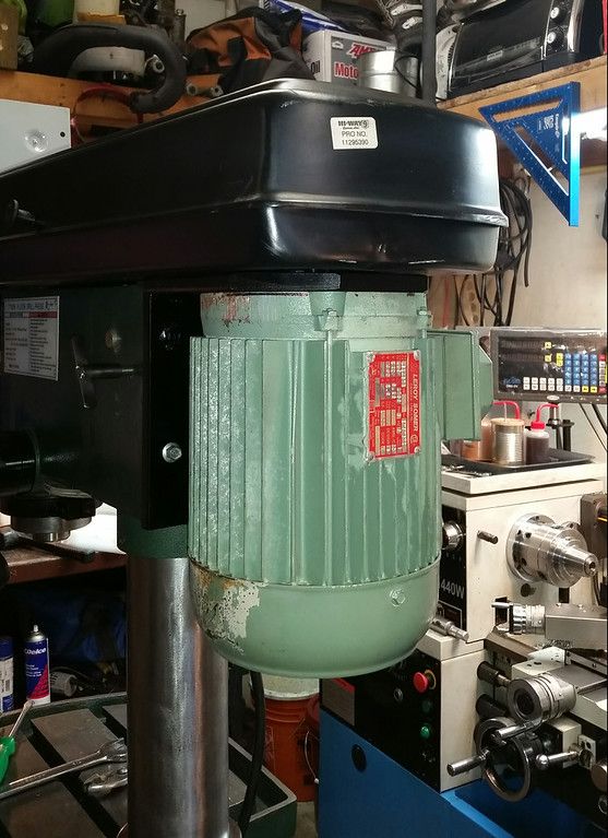

I had to build a mounting bracket for the motor as it was designed to be face mounted. I used some 1/2" X 7" hot rolled plate left over from another project. A little overkill on the size of the steel but it was laying around. The motor has a 4.5" raised flange centered around the 7/8" shaft and a 4 hole bolt hole pattern. I machined the holes on the mill using the rotary table attachment on my 8" super spacer.

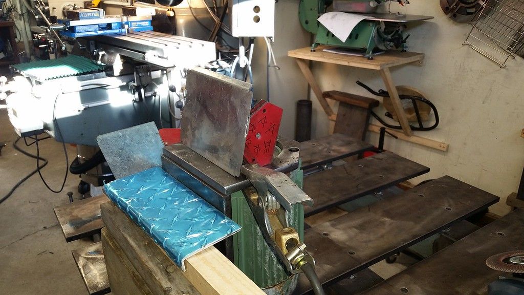

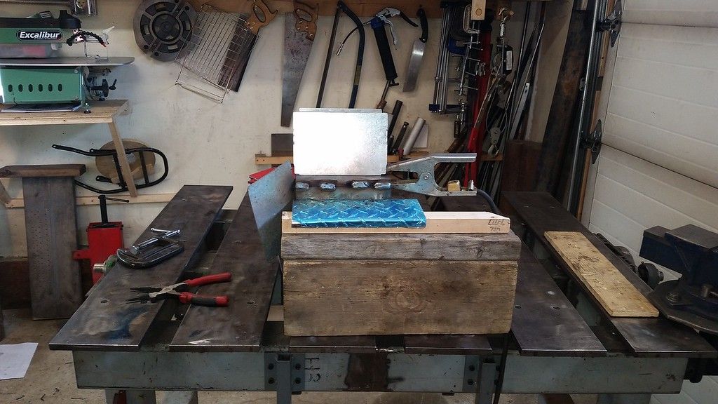

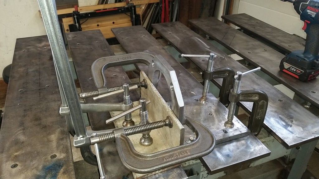

I mig welded the 2 parts of the bracket together. Outside welds done with both parts bolted to the motor and inside welds done with the bracket firmly clamped to the welding table. Amazingly the 2 parts were still at 90 degrees to one another when welding was finished.
I also welded the top 2 bolts to the bracket so it would be easier to mount the motor without fumbling with nuts and bolts. I painted the bracket black. It turned out well.

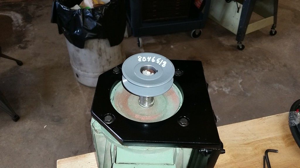

Since the new motor has a 7/8" (.875") shaft and the old one was 20mm (.790') I planned on just using a single groove pulley on the motor. After thinking about that for a while I decided I wanted the keep the multi groove pulley to allow for the maximum speed adjust-ability. Since I don't have any keyway broaches I did some careful measuring and found that the keyway in the pulley would still be deep enough to accept the key after removing .085" from the bore so I bored it on the lathe. I had to modify the pulley's 5mm key to fit the 3/16" groove on the motor shaft. I used the belt sander to make a .009" step on one side of the key.

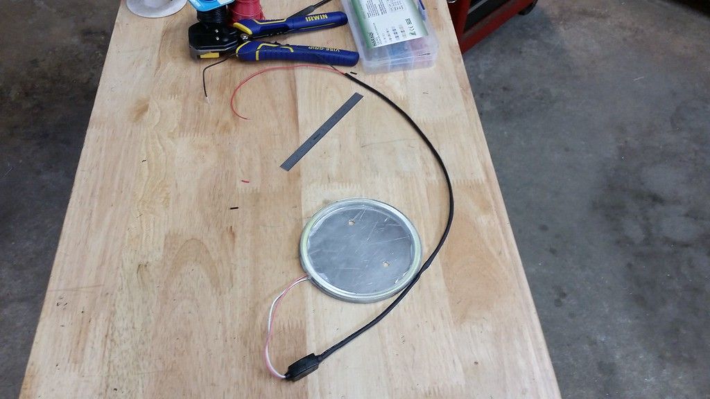

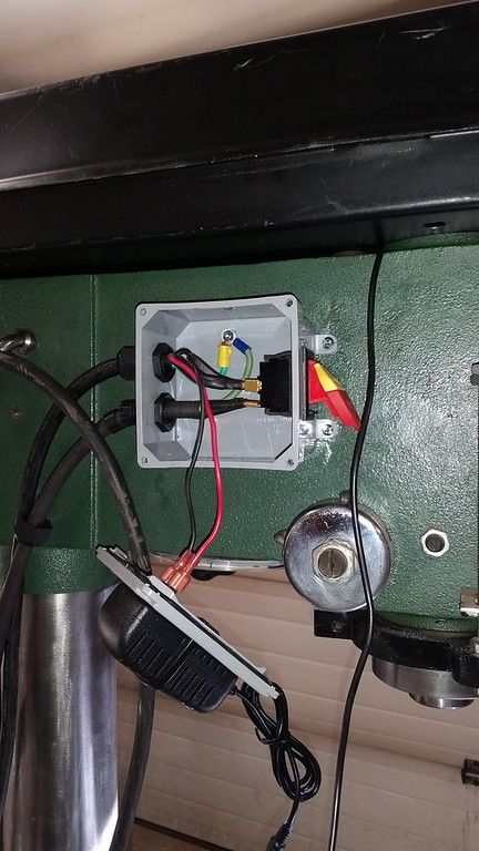

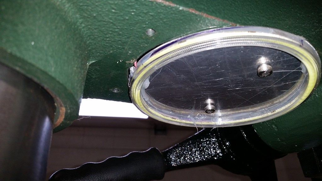

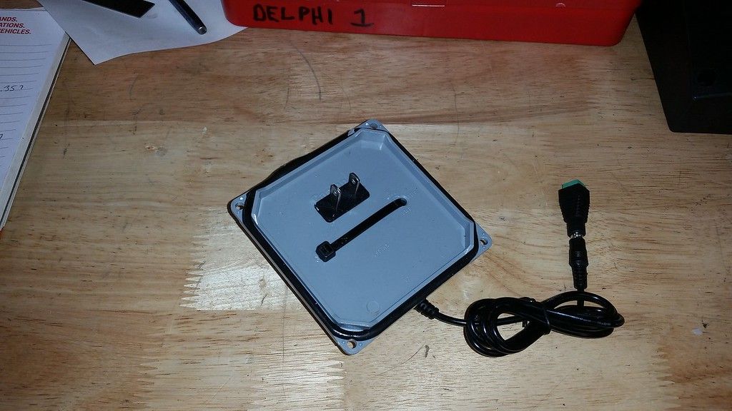

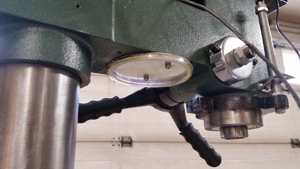

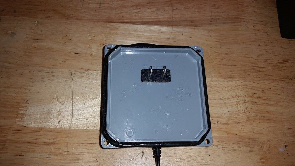

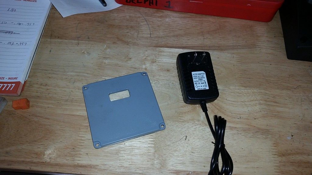

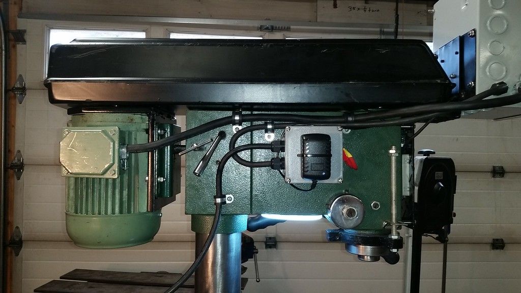

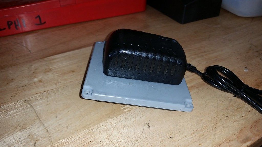

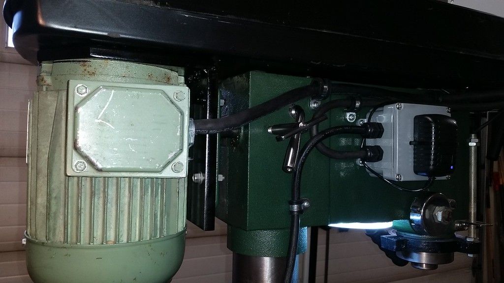

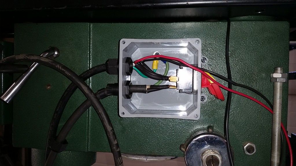

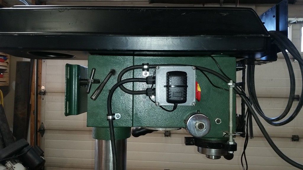

I installed an led light where the original laser aiming gizmo was. That light and the tachometer needed a 12 volt source so I used a 12V wall wart power supply and hard wired it to the 240 volt single phase supply. I mounted that and the power switch in a 4" X4" X 2" plastic electrical box. The power supply fits through the outside of the cover and I used some insulated female terminals the fit over the make spades on the plug terminals.
The light is just glued (with clear silicone sealant) onto an 1/8" aluminum disc I cut out on my scroll saw.

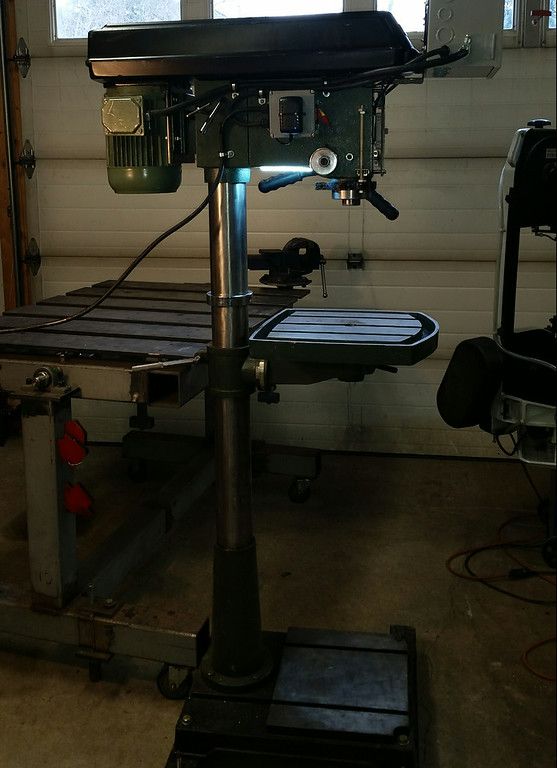

I mounted the box and vfd above head height on the front as it seems like the best place to keep it out of harms way from getting banged up when rolling the drill press around or from chips. I used rubber covered stranded 14 gauge cable to wire everything, 3 conductors from the wall to the vfd and 4 from the vfd to the motor.
I set up the vfd with a maximum frequency of 120HZ and a minimum of 30HZ. In the belt position I will likely use the most the spindle runs at 330 rpm at 30HZ and 1330 rpm at 120HZ. I rarely used higher speed than that since most of my drilling is in metal. If I put it in the bull low belt position I can get 100 rpm at 30HZ so that will be good for large hole saws in metal.
It turned out well and I'm pretty happy wit the performance.

The spindle pulley fits onto a taper on the spindle. The nut on top of the pulley is left hand thread but is only made of plastic. Once I got the nut off and made the pusher slugs it didn't take much force to remove either pulley but I think a puller is needed. There is not good place to pry under either pulley. If you need a puller I can lend you one.
The different shaft sizes are because the 3 phase motor is made in Canada and the single phase one made in China. I ran into the same thing when I changed the motor on my lathe. The pulley is cast iron and machined very easily. My final pass with the boring bar was a spring pass and the result was a fit .0005" tighter than the Princess auto pulley I was going to use. I used my heat gun to warm up the pulley so it was too hot to touch and it dropped right onto the motor shaft easily. Now it was too far on and I had to use the puller again to pull it back up the shaft to get the pulleys aligned before tightening the set screw.

Being able to remote the vfd control panel is a nice feature.
Where did you get the 220v wall wart?
YotaBota
Mike
I forgot about dual voltage warts, I may replace my battery with one.
Thank you sir.
Edit - after going to the link I realized that I have basket in the closet with old warts in it and AHA, there are a couple of 12v dual voltage units in the basket. Now I'll be able to put the battery back in the box with the drill.
