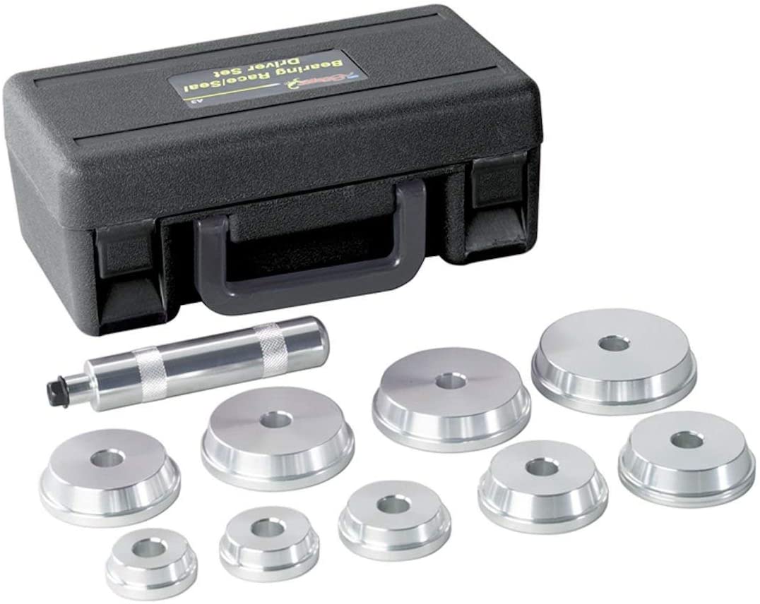

Or buy a set of cheap bearing/seal drivers
Trying not to go to town..... Apparently I am not fiscally responsible when I go to town or some such.....:D
