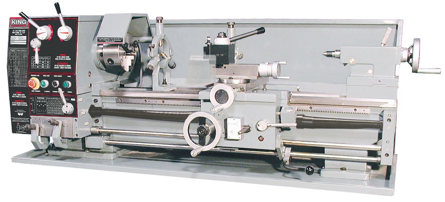

I have a guy about 10 minutes away from me that has a King 1236 lathe in really good condition. Just looking for a small lathe to use around home and put some hours in (non-apprenticeship hours obviously). I was originally thinking a 1440 or so but here in PEI, they are few and far between locally.
He’s asking 4000, which new, not on sale is about half price, right now they generally sell for 6000 on sale and another 500 to 700 for the stand. Just looking for guys opinions, etc. It’s just going to be for minimal home shop use, but I do work with a lot of mild steel. Just wondering how well it will turn bushings, small shaft, pins, etc..

$4000 is likely a good price if machines are hard to come by where you are.
If you're interested I would not hesitate to go look at it.

In my humble opinion, you will be very happy with a 12x36 for your stated needs. It won't complain or even get pissy on you for stuff like that. It's performance will be much more limited by your skill than by the machine itself.
If the previous owner has looked after it as well as you say he has, then you are a lucky SOB!

Comes complete with 6"-3 jaw chuck, 8"-4 jaw chuck, imperial and metric gears, quick change tool post, steady rest, follow rest, 10" DI-4 camlock face plate, thread chasing dial indicator, MT#3 dead center, MT#3 arbor taper, 1/2" drill chuck, full length splash guard, tool box, chuck keys and hex. keys
If the 4-jaw is missing, are the steady and follow rests included? The "imperial and metric gears"? Etc. If some stuff is missing, I would be doing a little negotiating on the price.
On the plus side, it looks like it was equipped from King with a standard BXA toolpost? If it comes with some tool holders, that is valuable. Any steel stock or other metals included? Even a few pounds of material saves you plunking (as much) cash at your local metal pedlar.
