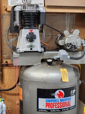

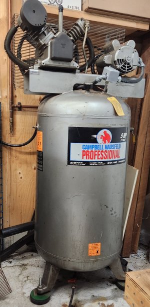

Well, after 25 years of service, she's gone. It started last week when air continously leaked out the pressure switch valve. So I replaced the pressure switch. But after it filled up to the upper limit tank pressure, the air still leaked out. Going on-line it was suggested that the check valve was the culprit. So I removed it, and found a tiny piece of metal stuck inside. Where the heck did that come from??
I cleaned it up, reinstalled everything and started it up. And at around 150psi tank pressure, everything started to shake. I threw the safety switch. Air was coming out the oil filler tube, the pump seemed like it was starting to seize. That tiny metal piece in the check valve was probably a piece of piston ring.
An aftermarket pump is about $1,000.00, so me thinks its time for a new air compressor.
I'm looking at the Ingersol Rand SS5L5: Single stage, 18.1cfm@90psi; 5hp 230 sinhle phase. $2,350.00 at Princess Auto. I better start making money quick! I've been without compressed air for a week and I don't like it!

Well, I finally decided to get a new pump, 5Hp, 2-stage, 175psi max, 23.0 cfm. Made in Italy....I think in the Ferrari plant:p Replaced the check valve too. Had to switch over the motor pulley to get the proper pump speed, and drill new holes for the pump footprint, and a new belt. Some new fittings and copper pipe (which was a PITA to get the bends right...well, good enough to work.) Put oil in and started it up.
Success! I adjusted the air pressure to 150psi, and it holds pressure...no leaks!
So this closes this chapter.

It looks good. Good to have air again, I bet. When mine was down it crippled so much of what I did.
Is the head cast iron?
It's funny how dependent you can get with compressed air!!
The black section, cylinder, is cast iron, the rest is aluminium. I wish it was all steel, but it is what it is.
