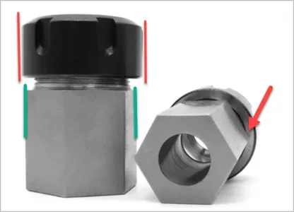

The only issue with the ER block that I can see is the tightening nut is proud of the block clamping width, which means the nut has to extend beyond the vise jaws.

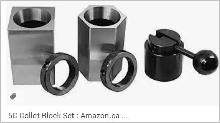

Its been a while since I've had my 5C in my hands but I think by using the slimmer tightening ring, the block can remain within the jaws without interfering. I don't think the 5C cam type tightener will work like this though. I would not go out & get a 5C set for this reason, but just pointing something out

I make fittings to adapt industrial valves to motor drives. Typical adapter is a 4” long piece of 1“ round bar, square spigot on one end, slot other end. Square spigot is done with the collet horizontal, slot with collet vertical. Same cutter for both operations. Piece of cake with the collet block, impossible with the 4th-axis rig.
I'm with the crowd that says both have their place. I have and frequently use a 5C spin Indexer, a chuck on a universal dividing head, two sizes of ER collets and chucks, and two each of hex and square collet blocks. I got both pairs together so I had a hope in hell of getting them the same, and so they are. The nice thing about having the collet blocks is being able to setup more complex operations and working on two parts at the same time.

Mine is like the one in the photo and I use the 5C collets from the lathe and the hex and square 5C collets I bought for those 'special' occasions.
