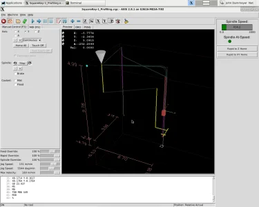

Perhaps a screen shot will make sense here too. Notice the buttons by "Spindle:"
Clockwise click on the Right Button. "Stop" button changes to an active "Stop". Then click on the '+' button to increase speed. The '-' button to decrease speed. Want to turn it in the other direction click the left button. You then have to press the '+' button to bring it back up to speed.
You can also create custom panels like the one on the far right. That shows the spindle speed as reported by the encoder and the bar changes from red to green when the target speed has been reached. I also added buttons to quickly move to XY 0 and Z 0.
