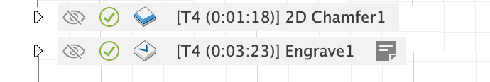

Argh. I've crashed my machine, shattered my carbide spot drill and bent my part all to heck, I then wasted an hour trying to straighten and face it flat again. I just need to start over with new material. I've done this a few times, or more, over the years and in each case I'm restarting the machine at an operation where the previous op used the same tool. Here are the two ops in Fusion using tool 4, first a chamfer, then an engrave op.
Since the second op is the same tool Fusion very unhelpfully and efficiently does not put a tool length compensation command into the start of the second op code. ie. no command like like line N835 below which is in the top of the first op.

I can't come up with a fool proof way to prevent this. I don't see anything in Fusion for options to force tool change and tool length comp even if the tool is the same. I could edit the code to put those commands in, either in the text, or insert manually a step between the two opts, or rearrange the operations so it always changes tools. Or try to live and learn and remember next time, I did remember, I was being careful but impatient, and I still crashed it. These tricks are not foolproof and while I might do this for a while, in a year I'll make the same mistake since I've done this a couple times.

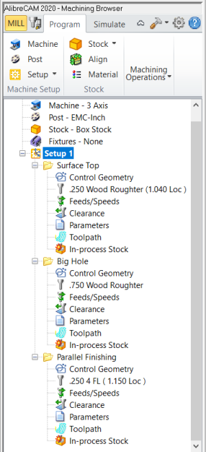

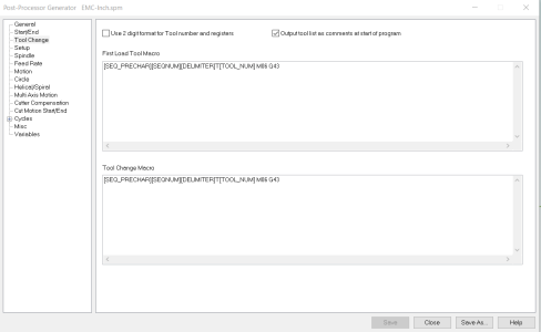

Inside the MecsoftCAM configuration is the post processor code. A tool change is independent from the CAM side as it's machine CAM specific. Here's the EMC-Inch (LinuxCNC Inch) dialog. The variables like {SEQ_PRECHARGE] is blank so it doesn't contribute. [SEQNUM] starts at 0. [DELIMITER] is also blank. Finally we have T [TOOL_NUM] which starts at -1 but is set by the G-Code generation. The M06 and G43 are always part of a tool change.
So here's an excerpt example of a CNC program to create holes and face with three tools. The spelling mistake "Roughter" is not mine. Came that way.
N1 G17 G20 G40 G90
( BEGIN TOOL LIST )
( TOOL 2 - .250 Wood Roughter (1.040 Loc ) - DESC: 0.2500 DIA, 4 FLUTE, CARBIDE MAT )
( TOOL 4 - .750 Wood Roughter - DESC: 0.7500 DIA, 4 FLUTE, CARBIDE MAT )
( TOOL 3 - .250 4 FL ( 1.150 Loc ) - DESC: 0.2500 DIA, 4 FLUTE, CARBIDE MAT )
( ENDOF TOOL LIST )
(Setup 1)
(Surface Top)
N2 T2 M06 G43
N3 S20000 M3

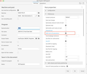

ok I got it figured out. It is not anything we discussed. The ghost second tool definition at the same tool slot number in Fusion tool library did not help. The post I think just ignored the second tool as it had the same tool slot number. But I found another option in the post set up in fusion, a check box. "Safe start all operations". That put additional code in the second operation block to change to the tool and reapply G43. I think that should do it. Hopefully I won't crash it again. Anyone running a HAAS or possibly any machine with a tool changer?... @Tom O

The option is here on the machine and post setup
