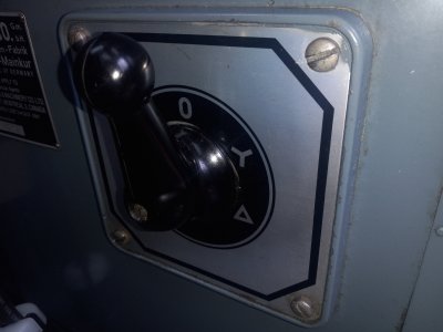

The new Meuser is ready for powering up (almost). It is wired 220v 3 phase and has been that way since day one. The power switch seems odd to me. There seems to be an Off, Star and Delta position. I plan on hooking the power up as per what it has now from the University (red to red etc.). The guy who facilitated the sale thought it was a high speed low speed deal but I don't know.
So the question is, do I need to be concerned with anything hooking up the power and selecting either position ?
Well, the goofy boomerang shape makes the motor whir and the triangle shape makes the VFD go nope. No sparks, no fires and I didn't get hurt, again. All in all I figure that for a win.
VFD's don't like being switched between them and the motor. If using a VFD, you need to use it to turn the lathe on and off. In my opinion the best way is to wire the motor to the VFD direct, and repurpose that switch to control the little on/off inputs on the VFD.
