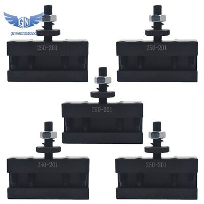

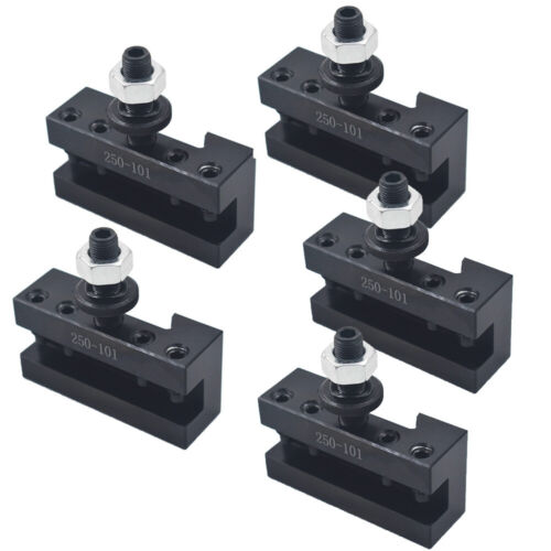

Mill your own tool holders.
My experience has been that the raw material costs about as much as the finished toolholders (Chinese of course).
Here are the last ones I purchased. Nothing wrong with them that I could tell.
