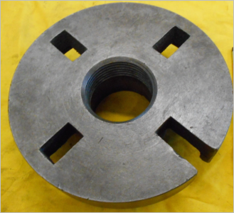

I have a couple of jobs coming up that require me to turn between centres. Previously I had just chucked up a piece of stock in the 3 jaw and drove the dog off one of the jaws. This works ok but I would like to refrain from running the dog against the jaws. My Bantam requires a somewhat hard to find MT 4/12 sleeve or centre to fit the spindle nose. I’m thinking about making a drive plate with an integer all MT bore to take the centre. Is there any reason I shouldn’t try this? I can’t find any commercially made versions, so I wonder if it’s not a practical idea. Any input is welcome.

- buy a D-style backplate. This takes care of the spindle fit up
- machine a hole if required to accommodate your dead center which fits in the spindle socket I assume
- machine the face to something like what the old style dog plates used to be. Some have slots of various sizes, some have a threaded for a an extending post

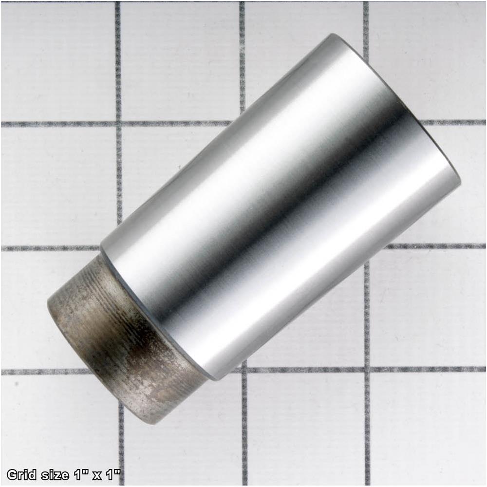

But, apparently Grizzly sells a sleeve:
(Picture looks odd to me, though.)
If the sleeve works, then you could use a standard MT3 drive centre.

The South Bend approach is a smaller drive disk threaded onto the spindle instead of the chuck. It has a slot for the drive dog.

I'm not exactly sure. The dead center (and the collet chuck analogy) has the benefit of longer contact area within the spindle seat vs a shorter longitudinal distance constrained by the dog plate thickness. It might also have to do with the size of the spindles (big hole) relative to smaller diameter MT center, but that's mostly a threaded spindle issue. Its almost like when the D-pin system became popular on lathes, you just don't see as many dog plates, which is weird. The used ones I see are often banged up in the dog slot which is a bit concerning. You are supposed to tie the dog back somehow so they don't smack on stop/start, but I've seen bigger dings.
Some guys bolt a dog pin on their faceplate, which I've considered too. But there actually isn't a lot of meat on the slot webs.
