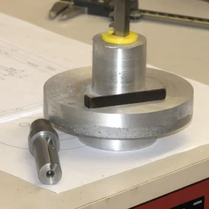

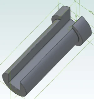

What a find! I've been buying my broaches one at a time with a few of the broach guides all from KBC Tools before the prices went too high. So I have 'duMont' brand in 3mm, 4mm, 5mm and 1/8". Along with a few duMont guides bought as I needed them. After the first couple I have started making my own. These were all purchased over several years.
The attached screen shot is one I'm doing now for 14mm shaft with 5mm key. The Broach is 'B' size which is about a 6.5mm wide slot.
The last one I made I turned the dimensions leaving extra length still held in the 5C collet. The collet was then transferred to the spin indexer on the mill and using a 6mm cutter on the centerline I roughed out the basic slot. Then 0.25mm on either side of the center line to clean up the sides and bring the total width to 6.5mm.
For a 6mm key slot in aluminum I was too lazy to turn the broach guide out of metal. Second photo shows the 3D printed version. I don't think that would work for steel pulleys. This time the broach was from China. Worked find in the casting.

Following on the subject of broaching I did get a chance to turn down a piece for the broach guide. Using a carbide cutter I ran 920 RPM, 0.1mm per rev, 0.025" depth of cut.
No carriage stop needed. I faced off the end after jogging to that point. Set Z=0. Then BEGIN=1.25mm. END set to -43mm.
After that a few passes with measuring to get to the 20mm diameter for the shoulder.
Then change END=-36mm to turn to the shoulder. Figure out I needed to cut to a depth of 0.117" with the caliper as a guide. Four passes 0.025" and one at 0.017". Left me with about 0.001" and I used a file to clean up the roughness. Now a micrometer to verify it's the same diameter as the motor shaft.
Still need to just cut a relief at the shoulder.
After that. Onto the mill to cut the broach slot. Think I'll write some G-Code for that. BroachGuide-14mmB-1.jpg

Sigh... Kind of wish I'd just bought one given the time I've put into this already. Broach fits nicely in the slot.
I used a 5mm cutter since it was a two tooth slot cutter rather than a 4 tooth end mill. Speed 2000 RPM. Depth of cut per pass 0.025" and F5 speed setting. Which I determined by a bit of trial and error cutting the shoulder near the spin indexer.
Then once I was sure the speeds were good I type in G1 X-1.9 F5 from the X==0.2 position away it went. right into the collet. Accidentally set -1.9 instead of -1.8.
Fixed that and then cut to the depth I'd worked out in CAD.
Now the cutter was 5mm but the slot needs to be 6.5mm and as I'd used my probe to find the center line of the part I figured I'd just move over half of 1.5mm and mill the full depth to get up to the 6.5mm width.
Didn't realize that the collision with the collet had damaged the cutter. So there was a ridge that I didn't notice and the broach wouldn't fit in the slot. So I kept making the slot wider until it hit me that the ridge was the issue. A bit of scraping and now the broach settled in place although now a bit sloppy.
OK. Cut it off, cleaned it up, tried it in the 14mm hole. Hmm Broach won't go through. Slot is not quite deep enough. The two corners of the broach stick out more than the top on the curved surface. Suffice to say I made a mistake in the drawing.
But that's not the worst of it. Turns out the slot isn't centered. Now how could that be?
I looked at the 3 other broach guides I've made in the past and what do you know. They have the same problem. Turns out backlash on the Y axis is enough that the positioning isn't accurate enough and clearly I don't have the LinuxCNC backlash values correct. From the bottom of the slot over to the side on one side it's 0.02" wider than the other; so only out by 0.010". Which fits in with the backlash.
I can probably clamp it in the vise and use a 6mm or even 1/4" (6.35mm) end mill to deepen it enough so it would work. Don't really want to spend money for a new one. It's not even in the Delta location so who knows when it would arrive or what shipping would cost.
I think I'll try and save this one.
jcdammeyer
John
Used a 1/4" 2 flute slot cutter with the broach guide held in the vise. Cut an extra 0.021" depth and moved it a bit either way on the Y axis to widen to 6.5mm from the 6.35mm cutter.
And it turns out my 3 Ton arbor press can do steel. Slot could have been only 0.015" extra depth so I had to add an extra shim to deepen the slot. Then a bit of work with a file to get it past the 'stiff' parts. A few occasional uses of the gear puller to get it off. Now it slides on nicely.
Next step, rotary table and 4 holes to mount the two pieces together and finally square off the nub to fit a 3/8" socket.
Once you have the ability to broach, and practiced a few times it's not so scary.
