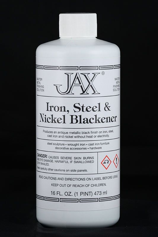

Ahh.... So that's what you needed the Jax for🙂
YES. I was not pleased with the finish on the 1 inch bar. My bottle of JAX is getting contaminated from reuse. I guess I should be discarding it after every use. If I get some new I'll sand of the old and do it over.
Most bluing/blackening solutions don’t like being contaminated and specifically state this (surprised that JAX instructions don’t mention this). I always pour a little of the solution into a small cup, use it out of the cup and discard whatever is left when the work is done.
