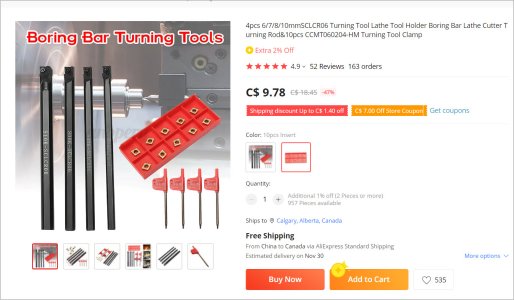

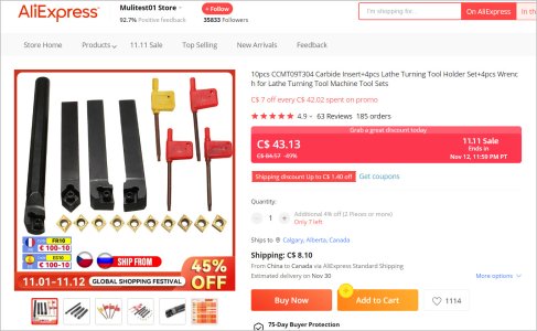

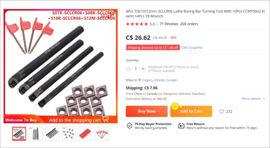

@Felis as mentioned, just go straight to the source. For the same price of ONE of those RDG bars you can a set of 4 including inserts. AliExpress, Ebay... some sellers advertise on multiple e-stores. Do some checking or some of us can provide you some store names. I just posted some quick screen grabs as an example. The prices & shipping vary a bit. Most of it comes from China. Avoid India if you can.
I prefer CCMT because they will work in small to medium/large boring bars AND they also work in conventional tool holders. So the same insert has more utility. Some sellers even have packages like CCMT lathe tools + boring shanks for a specific nominal shank size, but check prices. Its a bit crazy to navigate but eventually you will get there.
There is no advantage to DCMT for you, at least initially. The inserts are typically larger for the more common ones, so the boring bars are proportionately larger (maybe too large). The cutting performance is dictated by the geometry so choosing the right insert of either outweighs the style. there are scads of CCMTs to choose from. DCMT lathe toolholders offer some unique 'hockey stick' profiles that lends itself to the diamond shape, but that might be down the road for specific applications IMO
