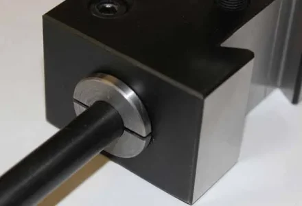

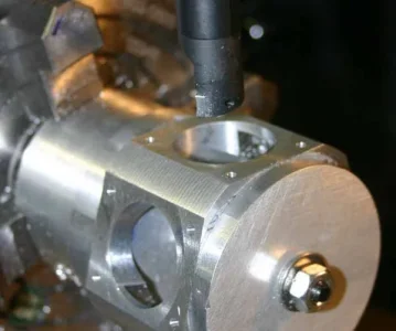

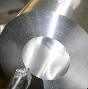

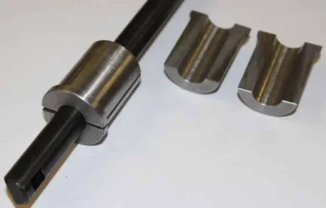

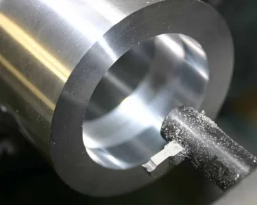

The KBC HSS type bars are useful like for relief cutting. The perpendicular tool can only bore a through hole. Boring to an internal flat requires the style where tool broach is at 45-deg. You can grind your own profile which is useful. Or for that matter, grind a Vee & thread. These are good to have IMO. But you need a way of securing the bar in your tool holder. The typical one for our size lathe is 0.75 or 1.0" which is too big for 0.375 or 0.5" bars. I machined some split bushings.
The ones in your last KBC link is primarily for boring heads. The ones I bought for this purpose are so crappy I have used them in the lathe. But they are relatively short so limited range & you need a green wheel to dress the carbide. I just ground flats on mine & clamped them in the rectangular tool block because they won't be used in the boring head. But I see no advantage to using them in a lathe over the other options mentioned.
