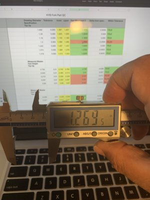

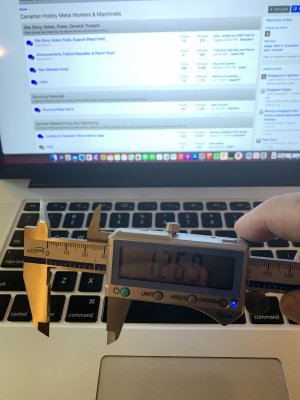

I bought the iGaging caliper I referenced above. It connects with your computer or whatever via bluetooth. When paired the caliper emulates a bluetooth keyboard. I put the measurements into a spreadsheet. Just put the cursor on the cell you want and hit the button on the caliper - it then types in the measurement and presses return moving you to the next cell down. Pretty convenient and more accurate than me trying to type. See button near my finger on picture.
I've discovered since then my other iGaging depth gauge and height gauge both have Micro USB outputs and all I need is the iGaging USB cable & adapter to connect those devices to the computer as well.

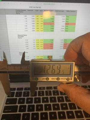

Here is my spreadsheet I'm recording values into for QC. The measurement in RED is the one I sent from the caliper under the column Part measured 3.
