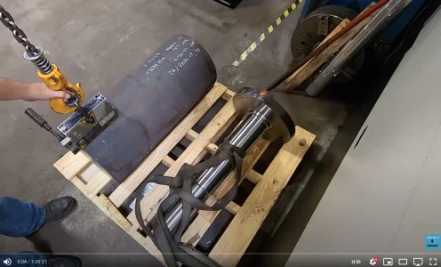

Same kind of idea as Edge Precision making this huge part:
Simple and highly accurate approach - but that is a lot of material to turn into chips.

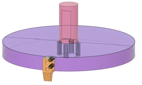

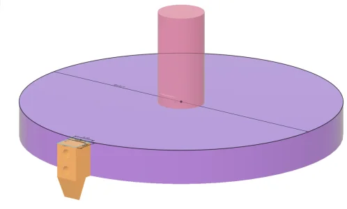

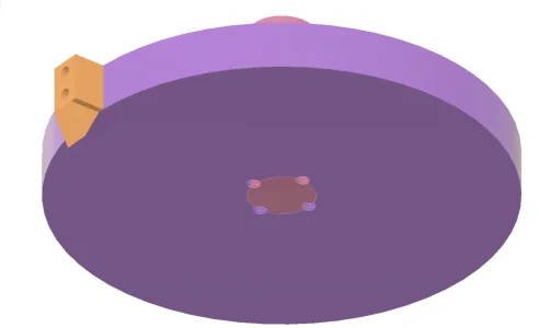

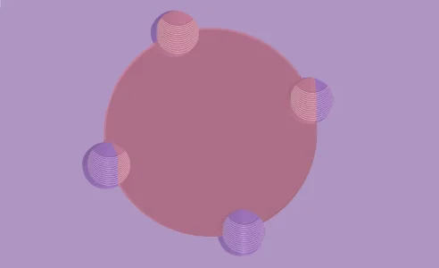

I was wondering about how else a disc could be attached to a shaft - tapers and key ways? Welding? Well no it would end up bent I'm sure. Well what about a press fit and drilled and threaded holes to replace a keyway? Is this a technique that could yield good results? Here is an example 1" hole with a 1.001" shaft - and interference press fit. Then holes drilled and threaded from the bottom 1/4-20 into the disc and shaft. Would the shaft end up 90 degrees to the disc? How big a press would one need to put the shaft into the disc? Would the screws even be necessary?

I think drilled keys like you have would be more than adequate. I would just leave the face & OD finishing to be turned in-situ so its perfectly balanced. (well.. except for the imbalance of the cutter but you have a big flywheel there).
You might be able to simplify the cutter by drilling a round hole matched to the circular shaft of a boring bar & then pins or set screws (since they have a flat) going in laterally like you have. Then you have all kinds of inserts & geometry options to choose from, easy to replace. I have butchered a few 10$ Ali boring bars for boring heads & other purposes & they work perfectly fine as long as you are using the cutting insert geometry correctly. I suspect the shanks are something like 4140. Don't do this on a high quality N-Am tool because the shanks could be much tougher material.
For the design you have drawn above, you have to compensate for the large forces that will apply to your joint. Think as your spindle as being effectively an immovable object... All of the cutting force( For example 100kg) will be trying to turn the joint into a hinge.
For the design as outlined, I'd suggest sweating the joint together. A superior design would use a second plate, say 3/4 of an inch thick to enhance the strength of the joint and stiffen the interface. Of course use the largest diameter you can for the central pin. Registration is completely unimportant as long as the joint is completely solid. balancing happens after the fact.

If you heat your fly cutter body in the oven and put the shaft in the freezer, it will fall in so no interference press work. You could put set screws in on the seam to key lock the two pieces together or v groove and put a small weld around the perimeter. You can only weld if no 4140 is used as a preheat may make the shaft loose in the hole while welding. If any thing is bent or twisted during assembly, you can always remachine it in the mill using the mill like a lathe and a cutting tool held in the vice.
You could machine a shallow taper and a shoulder onto the shaft end. Have a matching socket in the disc. Use a draw bolt to pull the shaft into the taper up to the shoulder. The shoulder increases the stiffness of the assembly.
In the video, he cuts a lathe tool holder in half (or about in half). He mounts the cut-off end on the opposite side for balance. You could always weigh the two pieces and match them by drilling lightening dimples in the heavy part.
