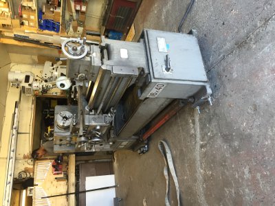

I moved my 4000 lb lathe, with driver direct with a picker, not sure how much they charge from Edmonton to Calgary, your machine is relatively light

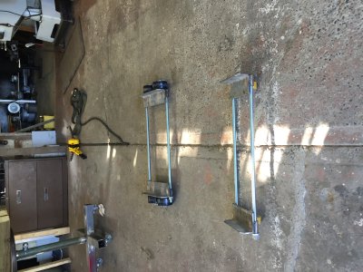

there are several way to move it, you can use the jack and roll method, I made skates for mine. I have a post under the old lathe project which show the roller I fabricated for the move. my garage door is only 7ft high also
hey Louis, I couldn't find your posting concerning the skates... since your profile is locked down I couldn't find it that way...
Any chance you could post a link to it? I'm very curious.
don't know what's up with my pic's they keep coming out sideways
my post was under Your Active project/Old Lathe Project
Any chance those skates are available? Look pretty skookum idea but I've only got 1-time use so doenst make sense to make my own
Wish I could help but they are under the lathe at this moment.
