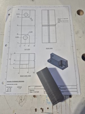

I have a piece of steel (appears to be hot rolled). It's 38.5mm x 38.5mm x 85mm and I need to reduce it to 30x30x82.

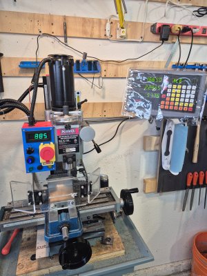

The machines I have available are a benchtop mini mill (King vs15) and a DMC2 Mini CNC and unfortunately, I'm not properly setup (yet) to cut the excess off with a saw.

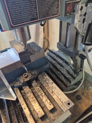

I'd use your mill and a 1/2" endmill (I'd use a bigger end mill on a bigger machine). I'd take everything off but a cleanup pass off in one go and I'd work my way across in 1/4" passes. When I did my cleanup, I'd go just under full width of the 1/2" endmill - that or use a fly cutter or face mill to clean it all off in one pass. On the other side, only a cleanup is needed but maybe not even that.

Well the verdict is in. I made a part (or the first step)
I ended up using a 10mm roughing mill at 885 rpm and 225mm/min (hand feed), DOC=5.775mm, Stepover=4.5mm. and cleaned it up with the fly cutter (first time using)
Took a bit but turned out OK for first real part. Now I need to work on the feeds and speeds.
The part ended at 29.78x30.3x81.99. Close enough for this project.
