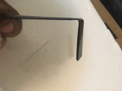

Had to pick up material got work today in Delta and couldn’t resist making a stop at KBC.
They had a King 8” grinder for sale, probably not the best but it will do for now. Everything on the used market was either way overpriced or absolute junk and still overpriced.
As recommended by @francist and @David_R8, I will be building a tool rest before putting it in service. Stamped 16ga chinesium isn’t going to cut it.
I would like to get a belt sander still but I think it might be a build project. They had a Kalamazoo 3x42 on display for 899$ And it was unimpressive, didn’t look sturdy at all.
