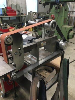

I also collected square tubing to make one as they seem to work well too. But with the development of no more welding. I decided to go with a little more elegant design. Also we have an actual KMG at work and I really like it.
I built one about 2-3 years ago and love it. Belt speed I forget what I calculated so it is what it is. Intent was to build it as cheap as possible and upgrade, truth be told works great, so why mess with it.
