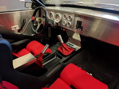

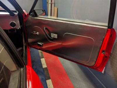

I did all the interior panels for my 79 Mustang out of aluminum. Its a lot of work. Start with cardboard templates then make the panels using the pattern. Layout the lines for the bead on the panel then work slowly following the layout.
