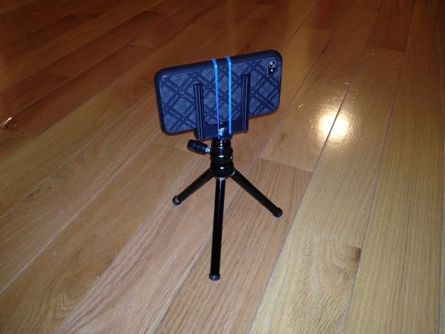

https://www.thingiverse.com/thing:25098
3D printed phone tripod holder.
CalgaryPT
I wouldn't have been at all surprized if you designed, printed and tested this between posts John. Almost disappointed it isn't a genuine Janger Holder.
