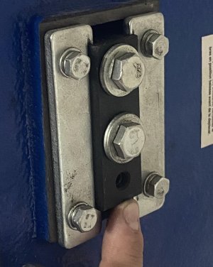

The idler wheels have a bolt / Allen set screw that adjusts the cant on the wheel. The axle bolt and the set screw I’m talking about are used to align the idler with the driven wheel which is fixed.
The idler wheel can be adjusted in and out by loosening/tightening both the axle bolt and the cant adjusting set screw simultaneously. Then the angle can be adjusted if they are adjusted independently.
Hopefully this is making sense.
If it doesn’t I’ll take a picture of my bandsaw for you and point to what I’m talking about.
It took me forever to figure that out and get mine tuned properly.
The bottom hole on there I’m pointing at has an Allen head set screw. The middle bolt is the axle bolt I talked about.
You can mess with those to change the angle and position of the idler wheel.
I angle it slightly “in” so that it keeps the blade on if you know what I mean.
Pain in the butt.

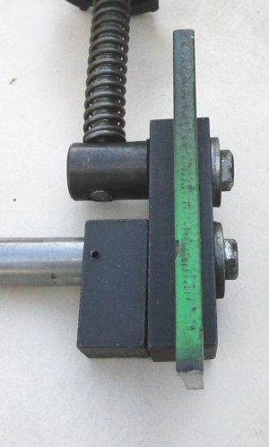

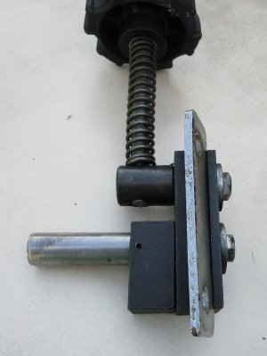

Hi BaitMaster, Guys,
On my 6X4 band saw the guides that the adjuster block slides in were so loose (thin) that you couldn't reliably adjust the the blade carrier wheel properly. I replaced mine with two new support pieces made from 6 mm thick steel plate milled down so that they were a good sliding fit. After that the carrier wheel could be adjusted properly. This cured the tendency to throw the blade.
These two pictures show the before and after I replaced the guides. The green piece is 6 mm plate. You can just see where I milled it down for a good sliding fit in the groove. The picture above this one clearly shows the old plate canted at an angle because its so loose (thin).

Great job. These bandsaws are a little bit of a hassle, but once you have them running….. I’ve cut ALOT of stuff with mine.
Good job.
