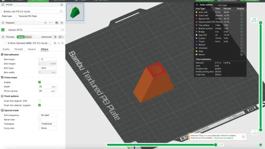

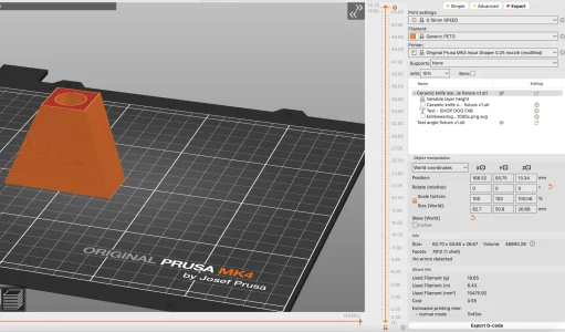

I'm printing with a 0.25mm nozzle on my MK4 prusa. I'm experimenting with printing text and a smaller nozzle was recommended. I also want to change filaments automatically to print text in a contrasting colour. So that got me thinking about the bambu PS1 with 4 filament automated filament changer. I put this model in to the bambu slicer with a 0.2mm model, print time is 3:30 hours. It's 1:45 hours on my MK4. The MK4 is 0.25mm nozzle so a bit larger than the 0.2mm nozzle on the bambu so I expected some slowdown but not double the print time. What's going on? Somebody with a bambu please slice and adivse. It's attached below. I've got an adaptive fill on both slicers, 3 perimeters, PETG, layer height similar at 0.14mm and 0.15 mm on the PRUSA. I do have adaptive layer compensation turned on with the Prusa - I don't see where that is in the bambu slicer.

PETG on Prusa with 0.25mm nozzle
1h:45

Switching to PLA on the Prusa did not change the print times (a few min different). So the Prusa MK4 is faster than any of the bambu printers with PLA or PETG with the model and high detail level I am working on. The nozzle diameter is not the same however so it is not quite (0.25 to 0.2mm) comparing oranges to oranges.
Prusa does not have a 0.2mm profile and bambu does not have a 0.25mm nozzle or profile available. hmm I'll try 0.4mm as that is available on both printers.

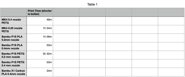

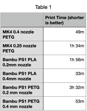

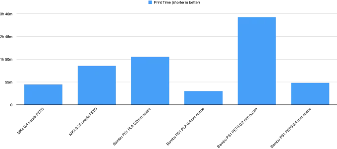

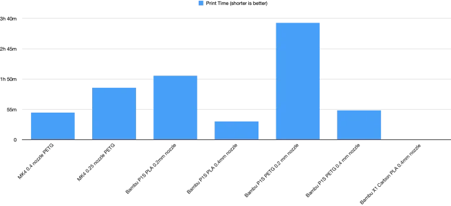

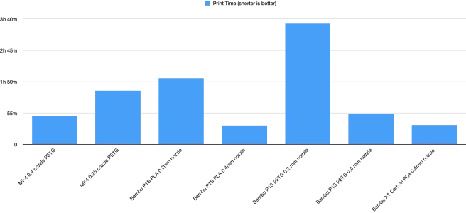

Race results - resliced everything with the same model in the same way.
Conclusion - with PLA and a 0.4mm nozzle the bambu is faster. With PETG and a small nozzle (but not exactly the same size) the Prusa is faster. It really depends on what you are printing, with what nozzle, and what material.
EDIT -> added a Carbon X1 time for comparison.
