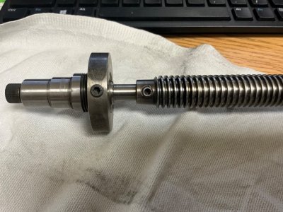

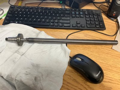

We have the above unit 6X12 size. Likely many decades old. Anyway recently I replaced the oiler that had stopped working. Naturally as soon as I did that, all the ways are being lubed again! New complaint! The head drops after the operator stops lowering it down. Oil makes things slide! Ruins the work of course. The leadscrew and nut are worn out in the middle of travel. We are not going to wait for a hard to find 7 1/2 tpi screw so boss ordered a 8 tpi and new bronze nut. He hands it to me and says “make it work”
I had a used screw from a previous junked machine, which gave me the upper bearing portion and I made it fit into the new leadscrew with a press fit and a pin. Heated the top of the screw to expand the hole and get a tight fit when cold. Screw is soft as purchased.
I cut the bronze nut to fit and installed the parts today. The hand wheel has 50 graduations which now I have to replace with one that has 40. The users are happy again!
Roton supplied the parts. Under $100 CDN.
Pierre
Just an update.
Since the leadscrew and nut combo is not perfect, about .010” backlash, the wheel can drop a little bit as one is working. So I made a backlash reducer. Purchased another nut and added some splines, edm a matching arm and added some Belleville washers to add downward preload. The arm could move back and forth through a small arc but tends to not do so.
