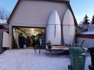

damn boats i never have time to use! hopefully buddy will rent a spot at the reservoir to put one so he and i can get out from time to time

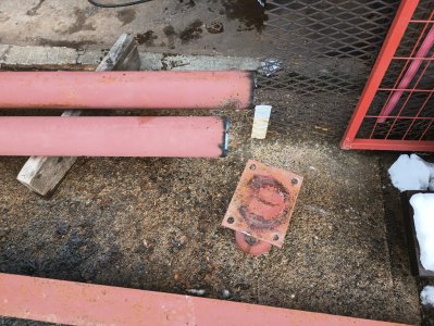

columns cut at a 5deg angle to match the slope, and capped

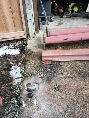

1/2 redi rod epoxied, 75mm embedment, i opted for epoxy given the rather close edge distance, wedge anchors as well as concrete lag bolts tend to put a lot of outward pressure and with close edge distance there would be a good chance of blowing the side of the slab out, the piece of hss in the center is taking place of the elevation shim pack, it is cut with that 5deg slope as well, both columns will get grouted at the end

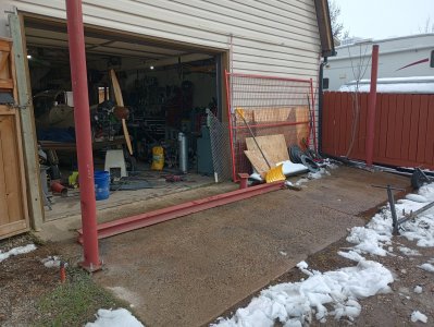

Despite the terrible spring weather i did manage to get the truss/hoist beam concoction modified with diagonal braces (although i ran short of round bar, the ends will have to be done in situ). The original plan was to stop there and have someone come give me a hand shoulder the truss up on a couple ladders, but with the addition of that beam the truss became quite soggy, i was able to get a genie, but they can be quite sketch, especially with the slop, so i opted just to make a couple welded hockey sticks and chain fall the guy up. Seeing as this had turned into being do-able with 1 man and there was still time left in the night i decided to get at it.
This is where it going to sit until i get back from Alaska, tacked up and ready to be welded out, and then on to the cladding.

Ha, take that rain! (although admittedly not much) Now i can watch the rain NOT come in the garage door!
