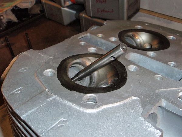

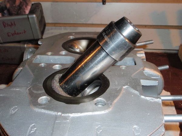

Yes you push the "punches" into the valve guide (they are tapered), then slid on the cutter to the "punch" and turn the cutter. May of them have a special T wrench that slides over the "punch" and the cutter has a hex cut on the top of it the wrench grips on to cut the seats by hand. Also that set has a nice assortment of diffrent degree cutters, which is handy for doing 3 angle valve jobs. I can't remember off the top of my head the 3 degrees you need to cut a set to obtain the 3 angle valve job.

The ones with the carbide blades are for roughing the 3 angles 30, 45 and 60 degrees. The plain looking ones with no blades are diamond lapping cutters for finishing. These are common in motorcycle repair.

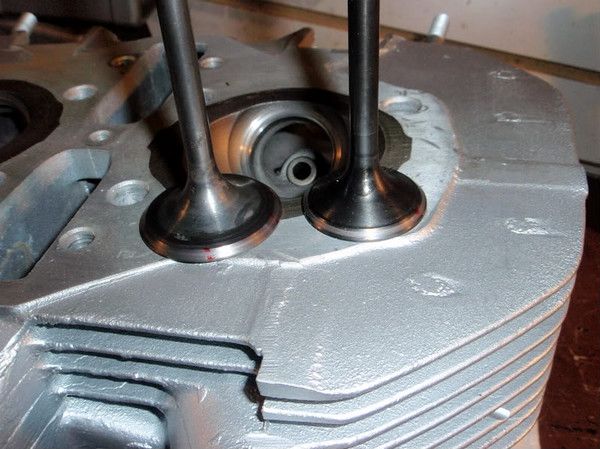

I'm not set up to grind valves, I have a friend who runs an engine machine shop and he does them for me ($50 for 16 valves) so it's not worth having a valve grinder around. It could be done in a lathe with a tool post grinder but the valve faces need to be concentric within .0005" so it's too much of a PIA for me to bother with. I had a Sioux valve grinder but there was enough wear in it that it could no longer give the results I wanted so I got rid of it. I have replaced valve guides on some motorcycles and some Chevrolet small blocks as I have the correct reamers for them. If I don' have the reamers it's not worth it as they are quite pricey. I do have the Sioux valve seat grinder and stone truing accessory as well as a large selection of stones so I could help you there. After this pandemic craziness is over bring the head and some beers and we can take it apart and check what it needs. This is some pics from a 1968 Honda CL450 head I did. I have the correct 6mm valve guide pilot for that engine and I was able to buy NOS valves for a reasonable price.
