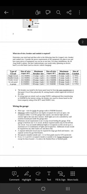

I have a question about upgrading the breaker running to my garage from the current 40a to a 50a. I believe the wiring is all good to do so according to CEC but would like better verification.
It's a detached laned home garage. 100a main panel in basement, 8/3nmd90 ~30ft inside home. 8awg rw90 x3 in ~45ft conduit underground to garage. 8/3nmd90 inside garage ~20ft.
I believe 6/3 used to be what would be accepted until ~2012? And now 8/3 is acceptable because it is good for 50a @75c however reading the internet it's a 50/50 yes/no and although I did download a copy of the CEC it's so large and I have no idea which table to look at.
Home is in Cochrane, Alberta if it differs from province to province. Here's a photo for detached wiring for Airdrie which is about all I could find but makes me believe 50a is acceptable with the nmd90/rw90 combo

OK got it, its a garage feeder and you wonder if you can use 75 degree for 50 amps.
You can as long as everything is rated 75 degrees or more in your whole setup. I.e. all panels, breakers, cables etc.
If the rating is not specifically stated its == 60C since you are under 100 amps.
Also note there does not seem to be anything rated 90 degrees.
OK, so here goes. This is my read. If you are going underground you need to use NMWU in the PVC pipe. To go to more than 40 amps you need to replace the 1.25 inch PVC to 1.5 inch PVC and pull NMWU 6 gauge wire.
That is what it says. You cannot use NMD90, as it appears it is no longer approved for underground use. My 6 gauge NMD90 installation is grandfathered - installed by a professional and inspected in 1995 (about)...

Sorry it isn't a new install. Installed already as built by the builder. 8/3 nmd90 in the house & garage, 8awg x3 rw90 underground in conduit. Just they used a 40a breaker and from what I can find is that it should be acceptable for me to install a 50a breaker.
They say in the same pdf that isn't the only acceptable method (nmwu underground) but they don't list the others.
The rw90 is definitely acceptable for underground, and from what I can tell also good for a 50a breaker because it's rated for 90 degrees like the NMD90 vs 60 degrees for the nmwu. But they don't want you using 90 degrees ratings so at 75 they should both be good for a 50a breaker?

The 90 degree cable rating is meaningless as almost nothing residential supports 90 degrees.
The deal is in the contactor - you need contactor rating.

"Rules 4-008 Insulated Conductors Types of Conductors Acceptable for Direct Earth Burial Direct buried conductors in contact with the earth are to be of the types listed in Table 19. Conductors installed underground in a protective raceway, or plastic pipe, are not considered to be in contact with the earth, therefore types such as RW75, RW90, TW or TW75 listed in Table 19 for use in "wet locations" are acceptable."
I.e. if he is in Calgary RW90 are acceptable.
Thus he does not need to bring anything up to code.
BUT, I am not sure about the permit part as you do not need a permit when replacing a breaker with the same type and size. But you are not replacing with the same size.

@Tom Kitta -you make my point. RW90 is the equivalent (or much closet to) of NMWU, not NMD90, and has lower peak capacity.
Hey, if the inspector okays it, then that's great! So I'm +1 on the call to the electrical inspector. I'm always looking to learn...
I guess that's the true question. Is the rw90 good for the 50a breaker as per CEC.
According to its spec sheet it's good for 50a @ 75c in conduit versus 8/3 nmwu which is only good for 40amps(because it's only rated for 60c) on Southwire specs sheet so I would have presumed it was similar to the nmd90 ratings.
So for some closure I decided to go ahead and throw a 50a in the garage feeder & also a 50a in the welder circuit. I checked all the connections between the two to ensure everything was good and ran an amp clamp on he circuit with each item in the shop in use.
