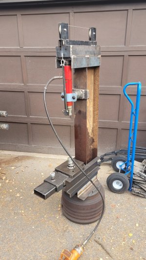

I hooked er' up to the shop air last night. The porta-power cylinder the original maker used, had a failed o-ring between the two bodies. Upon disassembly, I found a large, grooved seal that had basically come apart, looked like cookie crumbs.
I should have taken pics, but my hands were covered in AW32.
I've now done some minor modifications, to accommodate a cylinder I had in my hoard.
First was to knock this post off that held the porta power ram.
Diablo hole saws...love these things. At some point, I have to remember to make an adapter for em' to fit my pipe notcher.
Anyway, it took some time, and a bit of cutting fluid, but I got through the 20mm of material.
It's probably overkill, and will probly twist the I-beam better than the hips of belly dancer, but it's what I had.
The mounting lug on the barrel now comes through the top of the press, with a pin to hold it in place.
It's far from complete obviously, but I'm moving in a forward direction.
I have the power pack that accompanied the cylinder when I picked it up. From another hydraulics project, I have a control valve. So then it's just plumbing, and deciding where the power pack is going to reside.
At some point, I'm hoping to have a cart I can set up with the powerpack, and run it off the 220 in the shop.
Quick connects will be used. So I can move the power from one hydraulic tool to another....
A bit of inspiration from Colin Furze, that maniac maker in the UK...

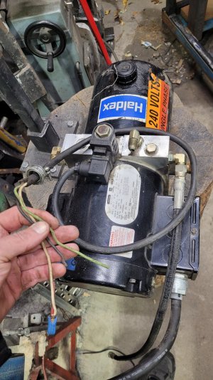

So, does anyone have hydraulics experience?
I have the skills to assemble hoses. It was a job priority when I worked for Napa/Traction in Fort Mac.
Beyond that, I understand that there is pressure and flow.
My challenge is with the hyd. power unit I have for this project. It was originally spec'd for use with a "dock leveler". Basically, a flat deck, that articulated, to get the loading dock level with the truck/trailer at a warehouse.
It took a bit of digging, but I came up with the manufacturers manual for the leveler, which had the subset of instructions for the hyd. unit.
I had hoped to just use the manual valve I have on hand with it. But after looking at the drawing the valve body cross section, I don't think I can. There is still one solenoid attached. It's got 4 wires out of it. I am assuming (bad idea, I know) that they're for power to the solenoid, and for in and out on the shuttle portion of the solenoid.
If anyone has some insight or suggestions...I'm all ears.
thanks!

That is basically all I need to do. But, I'm unsure of where to plumb off of to the hand valve. I think the 4 wire solenoid is for shuttling flow through the valve body.
I went back and found the manual....and it's in pdf...so it'll take me a bit to clip out the wiring section and post as an image.
I'm on a mac laptop...so everything gets convoluted for me...but I did get this to come up nice.
What I do not have attached, is the Lip solenoid valve SV4, and the lower manifold block.

I'd keep the solenoid valve. 4 wires give 2 for push and 2 for retract. The electric control cannot be beat for control, I can push as little as a 1/16" at a time.

KeeponDragon, I take it you have the block assemblely that has the reservoir attached to it and still mounted to the motor/pump? As per post #10. The manifold block most likely not needed is below the motor. Is the Main solenoid valve"A"SV2 there? The Lip extend port and the Manifold Port A, the Main &Lip Cylinder Retract Tee port I believe are pressure ports. The Lip extend port and the Manifold Port A, appear to be switched by the Main solenoid valve "A"SV2. Flow can be returned into the return port, just below the sequence valve. The orange marker has covered some of the drawing, so not able to see all the passages.
This is some guess work on it, may help or not.
The ram (black unit) is a double acting, will need to decide if useing spring/cable weight return or going to pump back.
KeeponDragon
Hello Bandit...thanks for the helpful insights...
The ram is a double acting cylinder yes.
here's a redo of the diagram without the high liter.
Here is the main solenoid valve "A" SV2 with 3 wires off it.
