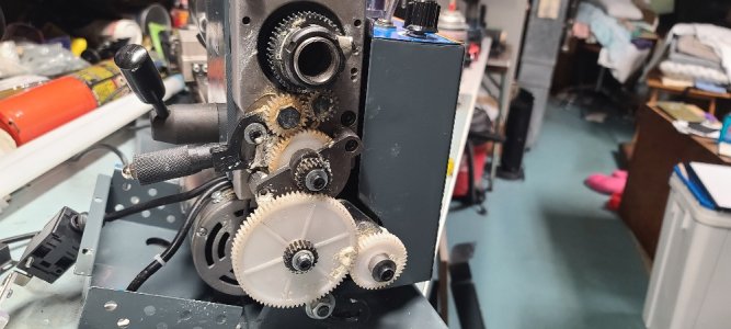

The reason I want to do this, is that the lathe is horribly loud during operation. I mean it really sounds bad. Rattling and screeching. I have narrowed it down to either the spindle bearings or the shaft that the motor pully attaches to that has the reduction gear. In fact, if I put the speed lever (high and low) in between settings, then the spindle doesn't turn and it sounds the same although much less louder. So maybe it isn't the spindle bearings but the drive shaft? Would the sound become much louder when it has engaged the spindle?

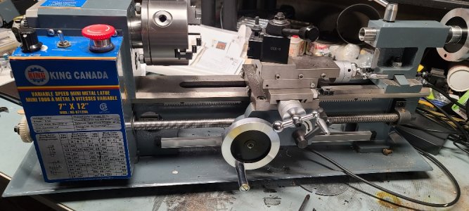

You have answered your question, it is not the spindle bearings. :) Picture of the lathe so we can see the whole thing plus one of the LH end without the cover might help identify brand although it is not likely to make any difference in the motor/idler bearings to order.
Your lathe looks basically unused, so spending more money on another lathe might not move you further ahead.

If the squealing doesn't disappear when the spindle isn't moving, then I'd agree with your diagnosis that it's the driveshaft that's the problem.
The change gear train is powered by the spindle, so that eliminates them as well.
This is assuming that it's not the motor - you've run the motor with the belt off?
I changed to angular contact bearings (unsealed) to avoid machining a new spacer. As I mentioned, it wasn't really necessary and I don't think it made any difference in performance.
And from your diagnosis, I think you can probably take spindle bearings off the 'to do' list.
My Micromark lathe is definitely a Sieg. Your DRO scale (nice!) hides the carriage shape which is 'H' shaped on a Sieg, The leadscrew end on my Sieg is different from yours, so the ID is still a question.
I've never read of a 'factory stock' Sieg or RealBull with shims under the headstock, so you should be OK to remove and replace the headstock. The bottom of the headstock is open so you will see things clearly once it is on your bench.
I drilled a couple of holes in the top of the headstock and pipe threaded them for plugs (as Steve Jordan on YouTube did) so I can shoot think grease from a spray can on the innards.
