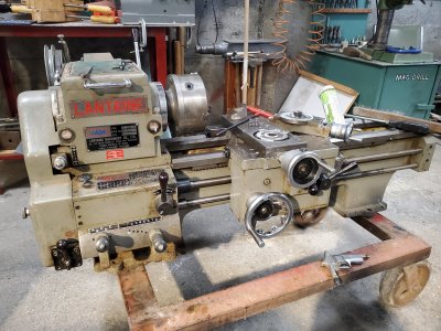

The new love of my life, I've decided to call her Lana.

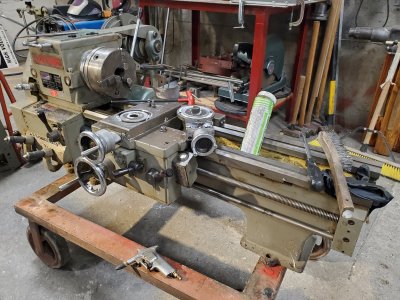

Once i got her home and unloaded, I just had to start giving her a nice bath, cleaning the ways before i moved the apron
On first viewing I noticed the tool post was separated.
I went to fit the tool post back on, rhe mounting stud was loose so i decided to take off the compound and cross slide casting.
All looked very good, like new, I cleaned, greased with some white food grade EP and re assembled.

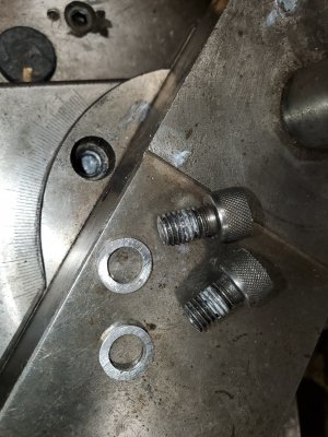

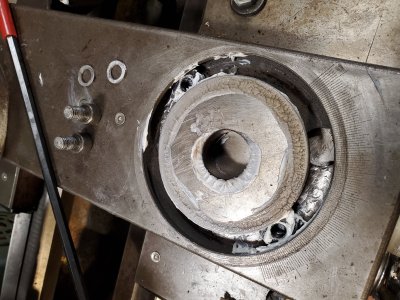

I went to put on the compound and discovered it wouldnt move freely seemed to dig in when tightening clamping screws. So i took it apart and quickly realized the screws were too long and dug into the bottom casting.
I took a pencil grinder with a tiny end cutter and cleaned up the gouges, ground the end of the screws and decided to make 2 tiny washers to raise the screws up a bit.
I like that better anyways because the screw sits on a washer, not the casting who's hole is slightly tapered from drilling.
I greased the compound put the washers and screws and now it tightens beautifully with little effort

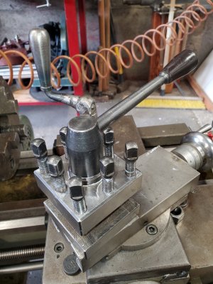

Next step, the tool post.

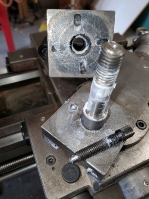

Some of the tool securing screws were mashed from overtightening, again I got the pencil grinder out and carefully removed the mangled end so I could remove without damaging threads. A quick trip to the fine wheel on the bench grinder some white grease and back together.
The detent ball was gone. Thank god I had a spare one. For some reason the toolpost does not sit square to the compound. Upon inspection the detent slots are milled slightly off center. As a result the tool post sits a few degrees off.
Does anyone know why this is?

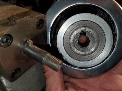

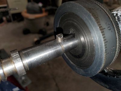

Now, onto the tailstock

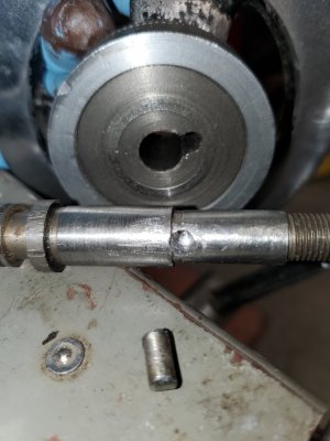

I was checking it out, and the handwheel was going in and out a half inch. Sonething obviously wrong , I disasembled and discovered a pin that was sheared, it must have broken and somone filed it off.
I carefully drilled it out and took a pc. Of 3/16 stainless roundand fit it in.
It was a bit loose so I tapped it endwise on the anvil and fattened it out a bit, raduis the end and it all fit back together with a bit of grease, nice and snug now.

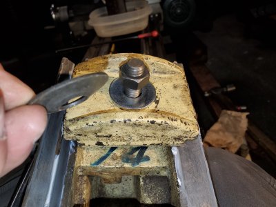

The thin washer under the pull up bolt deformed, so replaced that with a thicker one, adjusted the nut.
The 2 levers and hand crank were all loose, a bit of blue locktite, sone final cleaning and the tailstock good to go. Later when the machine is running I'll check the lateral adjustment
It should be adjusted such that it will ALMOST go over center when tightened, but not quite. Too tight and it won't tighten properly, too loose and it will go overcenter and you lose its functionality.

I really liked the detent on the Voest I had, it was slick. It wasnt a ball, it was an angled pin, very positive indexing.
I may re-drill the compound casting and change it to a pin in the future.
I may add a second heavy washer on the tailstock bolt add a jam nut and adjust it perfect like u say

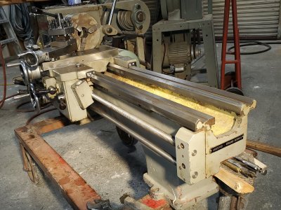

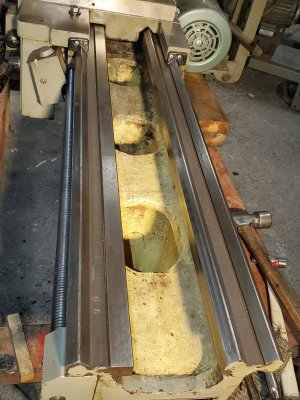

Heres a better view od the ways, they are almost pristine. I stoned off a few micro knicks near the chuck
