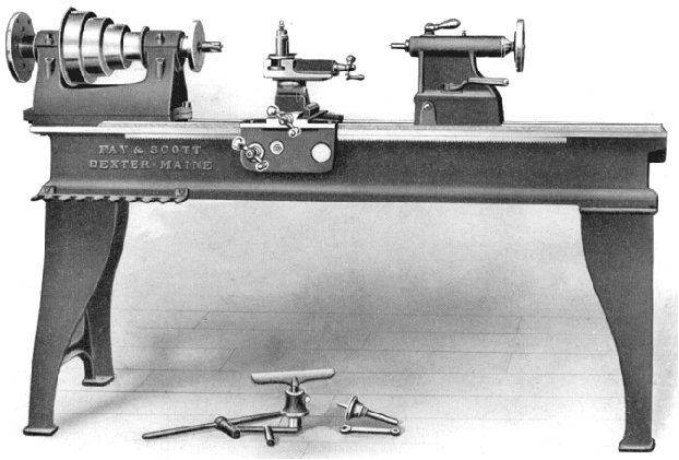

Making progress on my old Faye and Scott beast. I've even turned out a couple pieces I needed for other projects.
I find myself in the enviable, or perhaps unenviable position of pouring my own concrete floor and base for my machines. My garage is gravel floored and as such is a blank slate. Using a homeowner cement mixer of about 1950 vintage, I'm creating a floor in sections about 4" thick. So now I'm in a quandary.
My lathe sort of looks like this pattern maker's lathe bit with a different saddle, change gears, lead screw, etc.
The feet have about 1/2" holes in each one either to bolt it down or to install leveling legs. I've been reading here and elsewhere, some claim that gravity is enough, others bolt and shim it up solid. Here's what I see as my options.
- Manufacture some leveling feet and just sit the machine on the pad once it cures
- Drill appropriately spaced holes in the cured floor and tie the lathe down with wedge anchors, leveling with shims
- Make a CAD (Cardboard Aided Design) template of the positions and cast J-bolts in when I pour that section of floor and bolt down/shim the machine
So folks, if you were in the position of doing custom concrete work for machine tools, how would you go about it? I also have a camel back drill press to bolt down eventually, but that's more for safety and less for rigidity.

My opinion is that any lightly built or medium build floor standing lathe can benefit from be fastened down to a concrete pad. The reasons I say that are:
- Some lathes may have a twist in the bed and this can be corrected in many cases by shimming the legs and tightening down via anchors.
- If you machine larger offset items that cause a crankshaft type of action, or are prone to vibration (chattering), fastening the lathe to the ground will help dampen them.
A larger, heavily built single casting lathe does not necessarily need to be leveled or fastened down unless you are working close it's capacity. If it is fastened down, it can only benefit.
Remember to install on a single piece of concrete; never straddle a concrete seam.
I had several experiences with this.
On my Logan Lathe I had it both free floating for about 20 years and 10 years bolted down and shimmed. Both worked well. Bolting down ensured that the lathe didn't move if an off balance part was turned or if it got bumped hard.
On my current installation of the BB CX707 (about triple the wt of the Logan) I have it installed vibration control adjustable machinery pads.
Advantages with the heavier lathe:
- You can move it with effort if needed, otherwise it doesn't move.
- Pads conform to imperfections on the floor, making just that little bit easier to adjust.
- Any vibration external or from the lathe stops at the pads. Quieter running, better finishes.
IMHO controlling vibration thru hard fastening cause more vibration thru harmonics and standing waves. Pad isolation dampens them producing a better finish.
As to tipping over, not a concern, if it tipping is a concern you have other issues to address.
On a lathe with with only 4 mounting points (ie Logan) hard fastening allow better control to fine tune. On large or more modern lathes (CX707) it has 8 pads allowing fine tuning even with floating pads.

Thanks all for the information. I'll be bolting the beast down.
Now the question remains, install the anchors when I pour this section or drill after it's cured and use wedge or epoxied anchors.
Not being an expert, I'm thinking cast in place will be stronger, better tie in to the slab, etc. I'm willing to be corrected because as I've learned over the years, what may LOOK like common sense and logic is nothing more than a way to be wrong with certitude. I'm also thinking of making this section 4'x10' instead of 4x8. The lathe has approximately a 7' long footprint and I don't want to be tying it down right at the edge of the pad. I'll have to get creative with the wire mesh, but I have an angle grinder and a welder. :cool:

I'm convinced. Drill later and use the appropriate anchor.
Also I'm going to modify the drive so I use pillow block bearings for the driven cone and build a platform only somewhat above the head stock, not hanging from the rafters. That will also need to be bolted to the floor as well.
