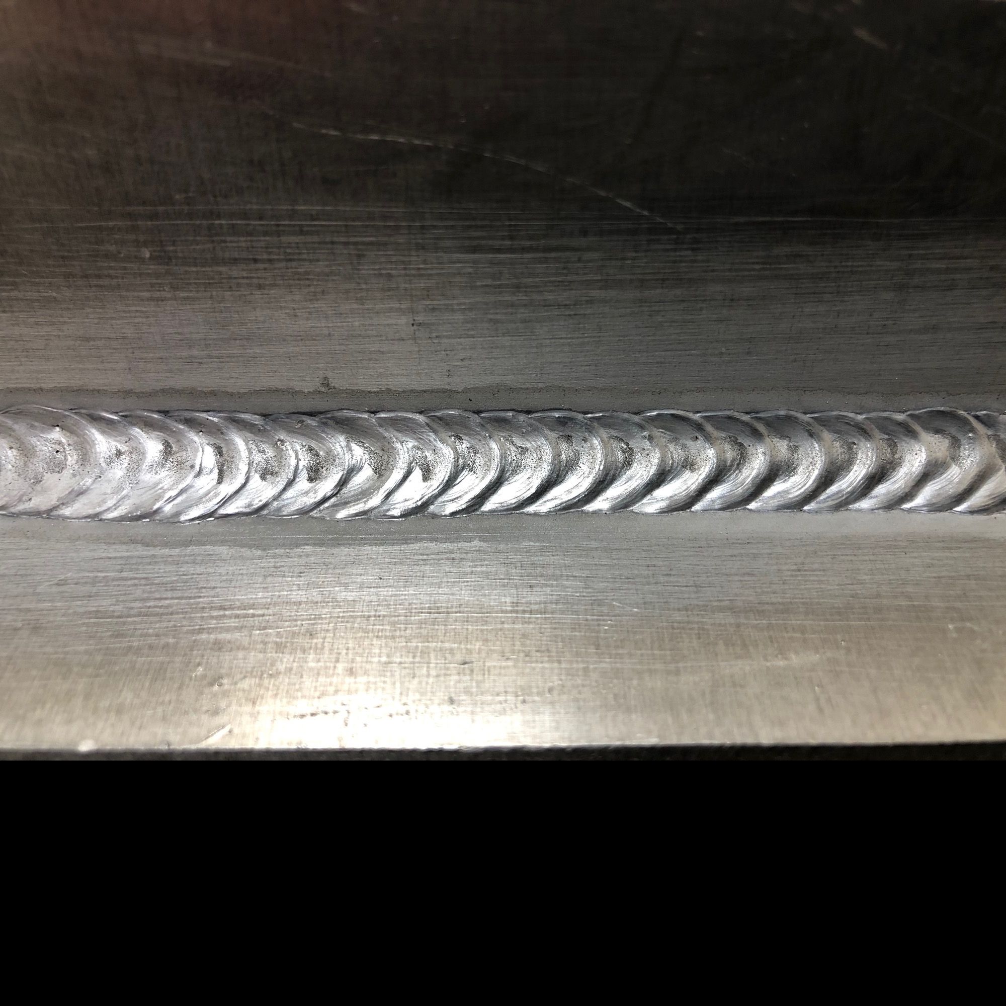

All good advice posted above. I would look into spool gun more then a push pull unless your gonna be making big fishing boat and or multiple boats. As there good price difference between the two. If you don't plan on doing lots of aluminum mig welding then I wouldn't worry about getting too expensive of spool gun as functionally they work about the same some have more bells and whistles or different tensioning methods for spool. Just make sure the connectors are correct and it can run at the amps to match the thickest aluminum parts you plan on welding then just fly at it.
You can do fair amount of welding with the small spools of wire. I would recommend whipping the weld puddle and a good mig weld for aluminum should look similar to the weld I'll attach to this post. Too big of steps you don't get the metal build up and no stepping or too slow you get very rounded welds and is just a waste of wire. Run on the hotter side as it's easy to lay lots of weld down but get poor fusion when running on cold side.
Also I would invest cold cut blades for circular saw or plasma cutter for processing aluminum as aluminum zip cuts are kinda the shits. Even good jigsaw blades work better then the zip cuts.
Weld to shoot for or even slightly tighter steps.
Nothing visibly wrong with this weld but its on the thin side from over stepping and moving to fast.

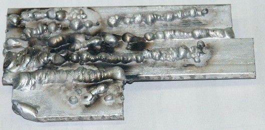

Not running hot enough gets results like this.
Couldn't find good picture of running too hot but you'll mostly just burn holes in everything or wire will burn back faster then your gun will spit it out. And your welds will be not be not as shiny and there will be excessive oxidation.
