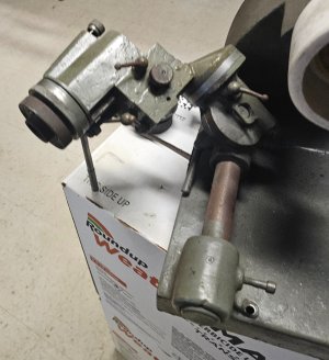

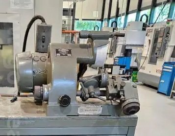

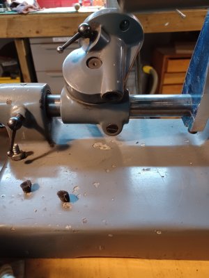

Here are some initial photos:
As advertized:

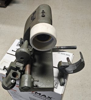

I removed the motor and drive belt to lighten the load a bit. The motor runs fine as is - very fast at 3450rpm, but quite smooth and low vibration.

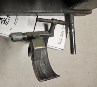

I lied, it did come with one badly worn wheel. I removed the shield to take a look at the stone. I think the little arm is a diamond wheel dresser. The shaft on the right is the motor mount.

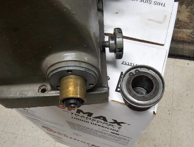

Here is the wheel and a bunch of rusty shafts. You can see that the collet holder is rusty too.
I couldn't fully articulate the parts. They might be frozen or I might have missed a lock.
I do not know if this is broken or just something amiss.
Gotta love that awesome paint job!
IMO it's still a bargain.

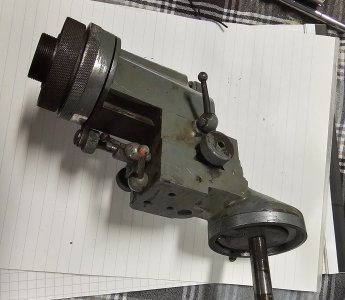

I successfully removed the main collet holder assembly.
I feel pretty confident that it's many subcomponents will yield to paint remover and my stubbornness.

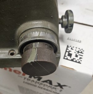

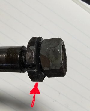

The shaft threaded washer was a bit of an issue though.
Even after removing the nut, that threaded washer (lock collar?) didn't want to turn easily. I had the impression that it is a friction fit component. I'll try paint remover on it first and then study other info before I try tapping it.
I have taken the hippocratic oath on this project - and I'll "do no harm". Yes, I know that's not an exact quote, but it is the plan.
The remainder is an issue. It is frozen to the shaft. I'm thinking I'll have to make some tools..... The true joy of my life!
I successfully removed the tightening bolt from the lower shaft clamp today. What a chore. Took me all day. With a clue from @Martin w's video, it turns out they painted over a set screw that holds the main screw in place. Even after scraping away the paint, the set screw didn't want to move. Although it takes a 1/16 allen wrench, the key slips. No metric or imperial key fits it as is. On a hunch, I ground down a 5/64 key to a scooch over 1/16 (probably 7/128) which held. I don't know if the set screw or my wrenches are out of spec. But given I prolly tried 8 different 1/16 wrenches, it's most likely an out of spec set screw. So I'll replace that with a proper set screw when I reassemble it. The screw also had to be worked back and forth like you would use a tap to keep it going 1/4 turn at a time. Even so, it complained the whole way squeeking slowly along. Once out, the clamp screw was easily removed along with two of the crappiest looking washers anyone could imagine. The screw needs some serious cleanup and some thread chasing. I might have to make a new one

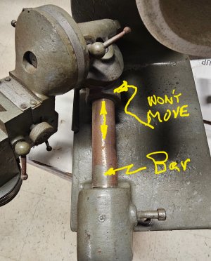

With the tiny bottom lever removed, I should have been able to unscrew the lever for the second adjustment body above it. But that was not happening. The upper lever won't clear the body of the grinder so it can't be turned. The problem is that the lower adjustment body won't turn on the shaft even though the clamp is removed. I examined it every which way of Sunday with no reward.
At this point I was beginning to get quite frustrated so I put it all aside for tomorrow and drafted this note instead.
