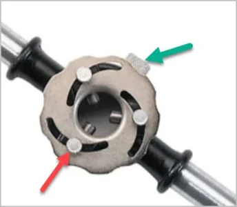

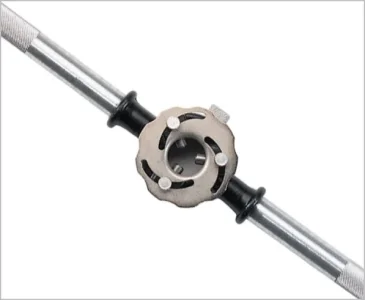

I've seen this style but never used one. It looks like it has a type of scroll mechanism. Do the 3 pins engage matching divots on the die head? Are they meant to accommodate slight variations in die OD or maybe gap opening set variations? I see them in some old-tymey sets but also a few current sets (Irwin maybe?) still use them.

I’m gonna go way outside my knowledge zone but I believe they help you centre stock in what you’re attempting to thread
So the (red) pins float independent to one another - that's what you mean by self centering?
And (green) is the (single?) lock screw?

@PeterT
The red “pins” are not pins, but threaded screws
Green is the lock screw to hold the die in place.
As you move the round dial it opens or closes the three pins/jaws, I believe thats supposed to close on the stock being threaded

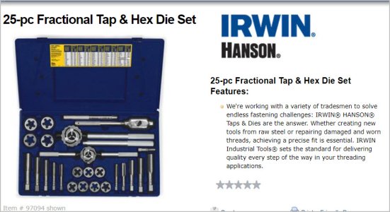

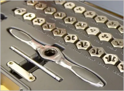

I think its for holding hex dies, not round dies. I believe there are 3 or 4 different outside widths, so this scroll type will accommodate the different sizes.
I wondered that too but you see die sets with round dies & same scroll wrench. Unless its just a perk for multi-use.
The hex style sets tend to have dedicated hex wrenches.
