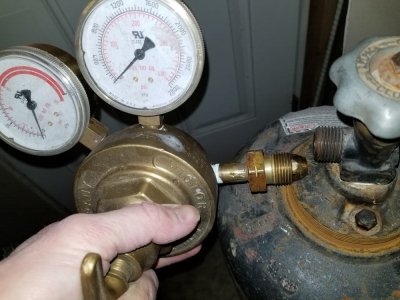

My new acetylene tank has a male thread. My old fuel regulator also has a male thread. Is there some sort of adapter I need to buy now? Please view the picture and let me know what I need to make this work.

The valve on your tank should be a CGA510 female. Looks like you have the CGA510 male on your regulator and your tank. I would talk to someone like OXYPRO to see if there is an adapter or if you need to change your valve.
This is what i have on my tank/regulator
You can just make out the valve/connector type if you zoom in.

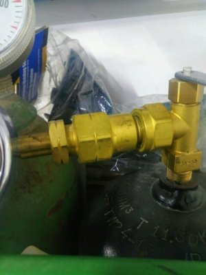

Yes your missing the adapter ...here's what it looks like on mine.
Don

changing the valve is not an option because the tank is full and i bough this at KMS. They don't refill acetylene tanks they just exchange your old tank for a new one. this worked in my favour because my old tank was expired anyways. I'll buy the adapter the idea of machining a one off part with left hand internal threads and a special mating surface makes me cringe.

Hi Alexander,
Can you post a photo of the front of the valve? I may know what CGA fitting it is that you need, but will need to check with my purchaser at work to source them.
