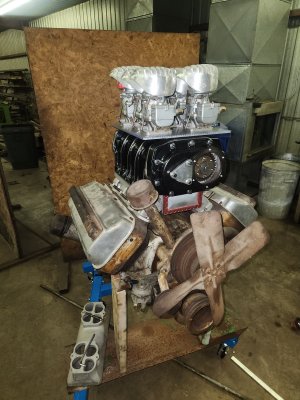

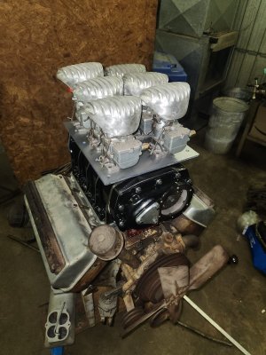

Sounds like the Strombergs may not being doing anything? Or is this a nitrous setup? What engine this going on? The beauty of a 6-71 blower as lots of air depending on the drive ratio.
Lots of engine pistons are cast, and engine heads. Any engine repair/machine shops near you? Or transmission repair shops, lots of trany cases are cast alum. As are totally hatched blower housings! Heavy machinery torque converters used to be alum. and maybe still are. We used to break up some for sand casting when I was in high school, (some time ago)...... Small engine repair shops maybe a source also.
Also looking forward to some pictures! Of the car, engine , sand casting, ??
This is just plopped together.
The air cleaners will be a helmet style that will come later. Stepson working on that idea.
The strombergs will be a throttle body

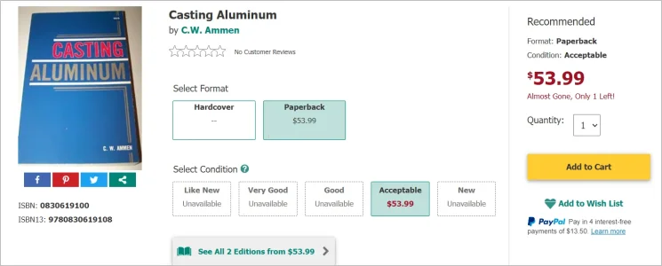

This post reminded me to check for a book I've been after which came highly recommended. Lucky me, found one (the last one) for a good price on ThriftBooks. Never used them before but shipping was reasonable so fingers crossed. AbeBooks was a lot more expensive.
