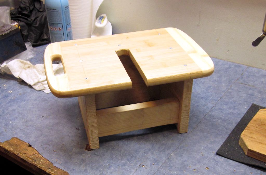

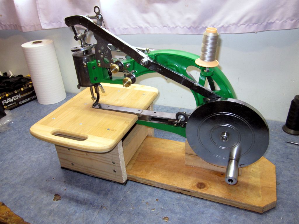

Spent some time doing improvements to the new sewing machine. A table I think that is the correct terminology.
and a bigger crank handle and some nice knurled thumb screws for the tensioners and stitch length screw.

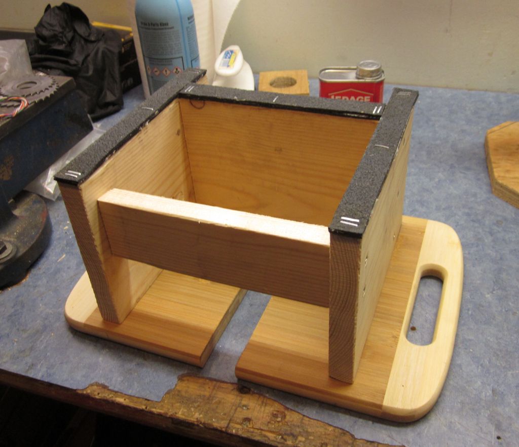

I also glued and stapled some rubber to the underside of the base I made so it doesn't slide around when in use.

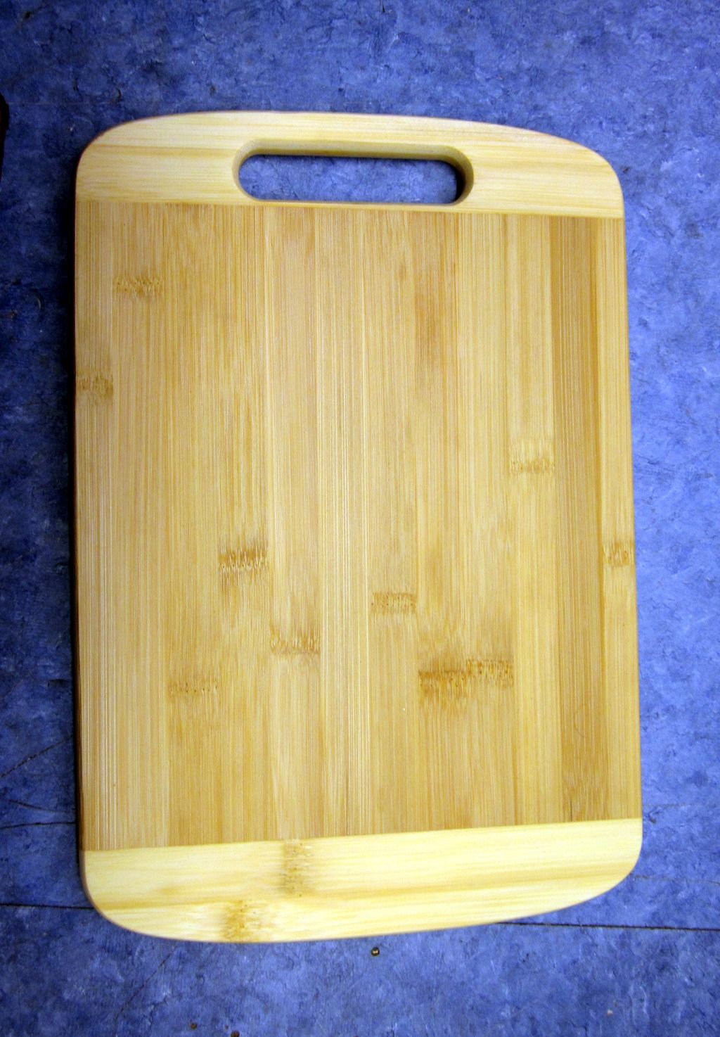

A $4.00 cutting board from the Dollar Store.

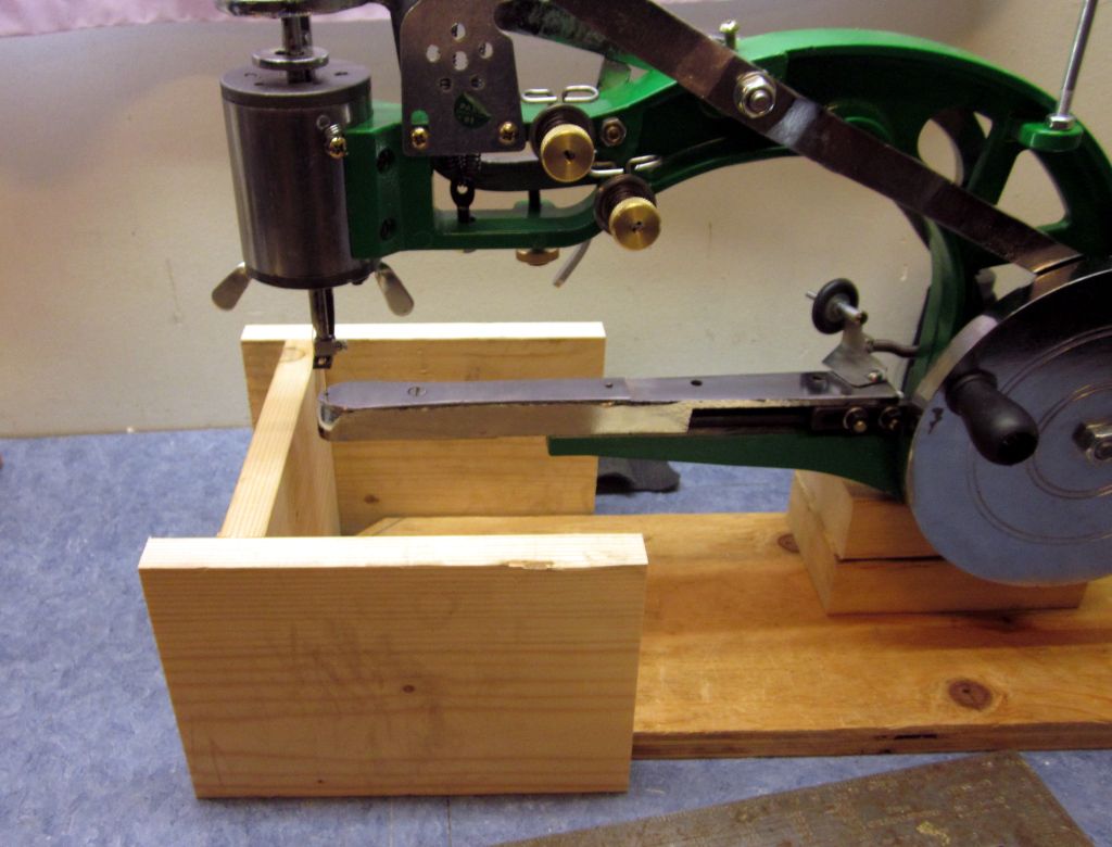

I cut a slot in it for the free arm.
The base for it from the scrap pile.
The completed base.
I glued and stapled rubber to the bottom.
It should be a bit more versatile now, especially because you have to feed the material through with one hand while cranking the handle.
